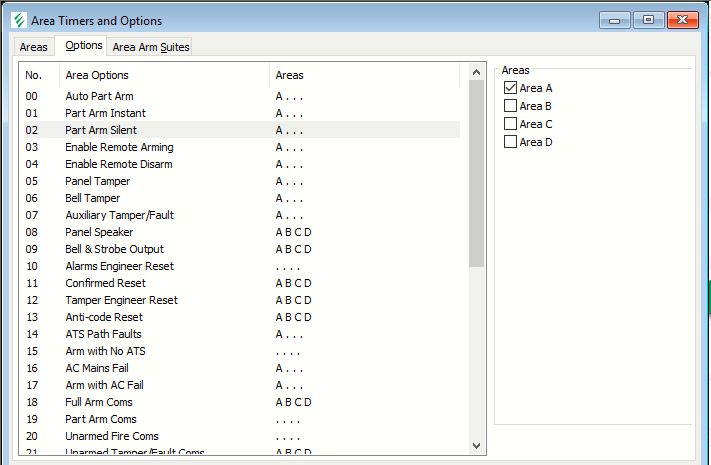

Does anyone know why my system will not silent arm?
Settings below:
As in speaker is sounding ? Or you get a bleep from keypad ....are you using any other areas ?
The Controller beeps a few times and so does the Keyboard.
Only using area 'A'
This is the Arm info for the arm zone..
It's not the same tones as a full arm - first the controller make a few tones then the keyboard beeps a few beeps then it Part Arms

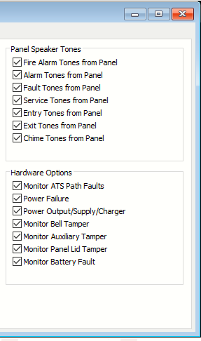

it might be 'set confirmation tones' ! How do I turn this off?
Will that has stopped the controller from beeping but the keypad still make a few beeps - but much better now TKS
Hi, I know this is an old thread, but I have the same problem too. I work nights on call and would like to be able to turn part arm on and off without waking my family.
I have a Premier Elite 24 with 2 expanders.
I have enabled silent part arm, turned off part arm squawk, disabled service tones.... Etc. I still get that tritone from the controller (not keypad) on setting part arm from the app.
Any thoughts much appreciated.
Yes, I have, for both keypad and both expanders. Thanks.
