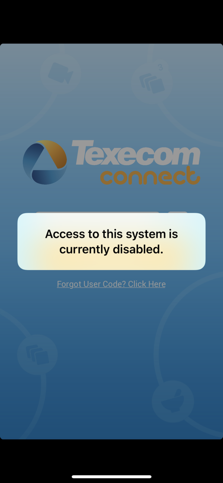

Hi All,
I attempted to setup the app for the wife and I generated a code fine but the app crashed after syncing bits and now when I try to logon to mine which has worked for months ok we both get “access to this system is currently disabled” The Smartcom is working fine as connecting to Wintex via it.
I have searched here and online but can’t seem to see anything relating to the message. I removed the app and tried newly created codes but nothing.
Anyone have any suggestions?
Many thanks!

I deleted app from both and created code on panel and started app and all started to look good it synced ok and then I confirmed devices and app said ready to use and at the logon stage I logged in and it says the same message about currently being disabled.

In the first instance access may be disable due to connection issues on your phone, however I cant see what is going on so its difficult to say with any degree of certainty.

I had this issue when setting up my Texexcom alarm and almost lost the will to live trying to fix it, what fixed it for me was to completely power down the entire system for say 30 seconds then power it back up. Once everything has rebooted the app should work ok again.

the smart com appears to be locked up from what you have said about the smart com lights and a power cycle should address that.
Texecom say that is an issue with a certain version of panel and smart com and flashing up should stop that happening again allegedly.
Resolved.
Issues:-
1. access via smartcom slow/ non existent (power cycle smart com),generated App code from panel and connected via wintex.
2. User codes in app didn't match what was in panel, indeed the seemed to represent the UDL pass code, not sure how that came about but changed via the engineers code in the app for all users to unique codes. Maybe related to previous attempts to set up will be checking with Texecom later how it may have happened.
