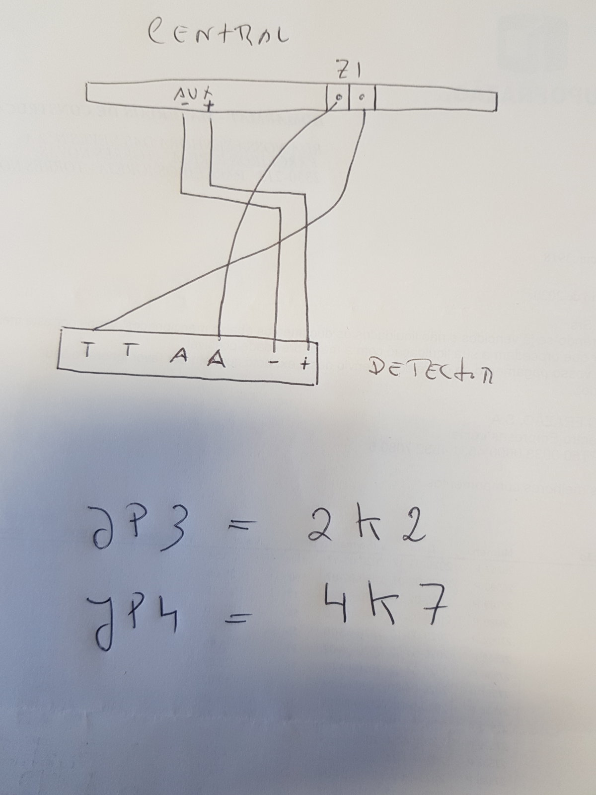

Can you tel me what is wrong whith a TEXECOM DT AFG-001 connect to a TEXECOM PREMIER ELITE 24.
ZONE CONFIGURATION : EOL
ONLY alarm anti tamper works. The motion detector do not work
THANKOU.

zone wiring type double pole EOL?
zone programmed as ????
leds on detector do what?
then look at eng utils zone status on the zone and what happens.
for a DT to give an active signal, both the PIR and microwave component need to pick you up
E/E is your issue???, guessing you don't have a door contact on the door?
Alarm doesn't go off I suspect because of how the alarm is programed.
Look at the event log.
