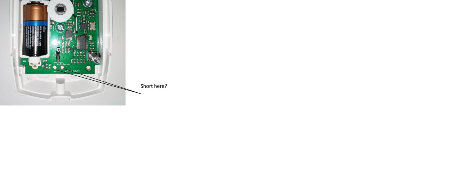

The panel recognises the expansion module, however, when it searches for the wireless PIR (sitting next to it), it suggests that I "Power Up The Device", but fails to recognise it after the countdown has elapsed.

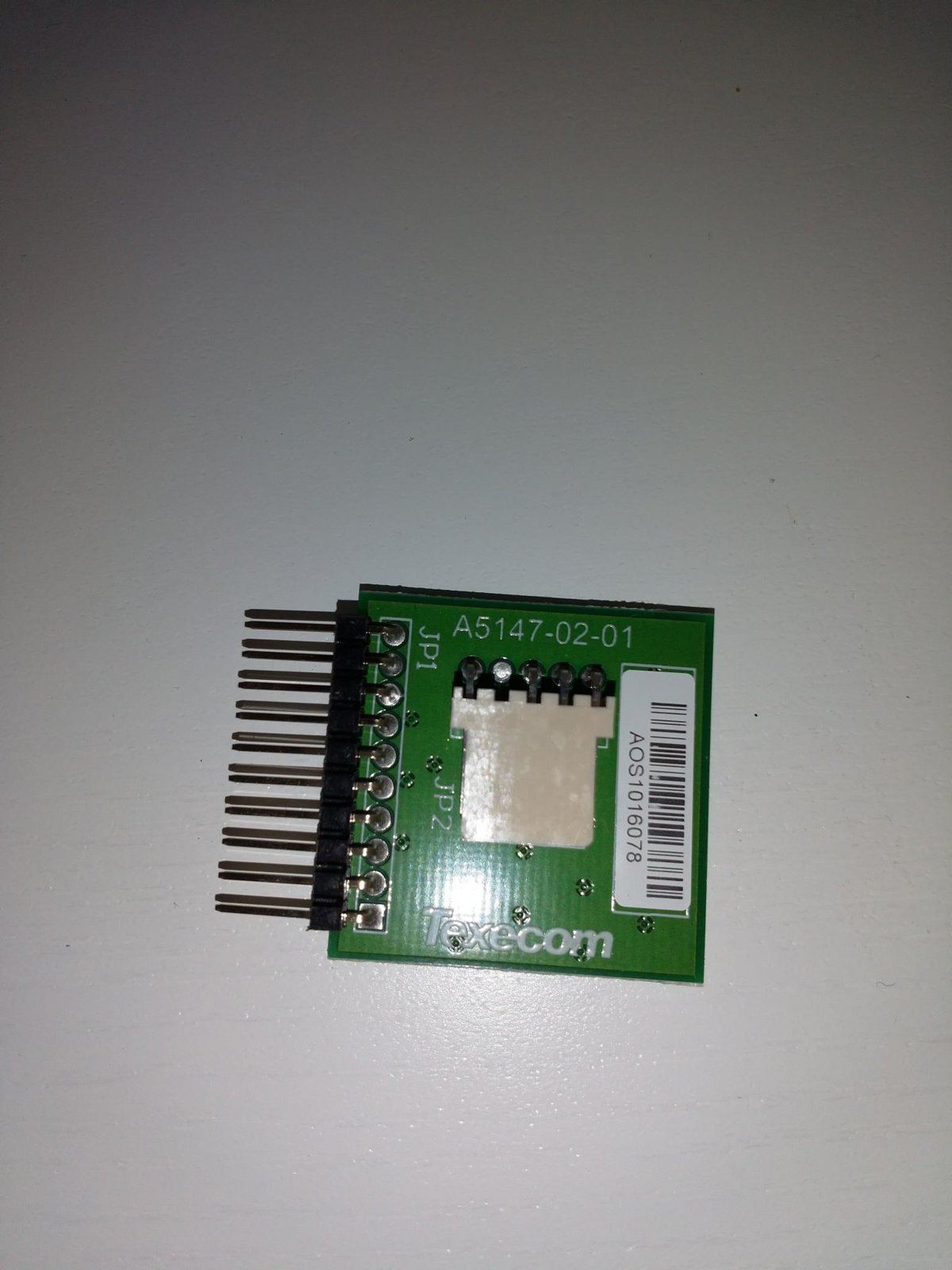

I also have no idea where the item on the attached photo goes..........It was included in a bag inside the 32XP-W

You have to insert the battery and short the learn pins at " power up now "
That other item converts the com2400 port to a comm port ( if required)

I had the battery in, but did not know about the need to short :). Do you mean short between the auto-learn pins highlighted on the attached photo?

That's hilarious, you actually have to put in the battery during the count! Talk about failing at the last hurdle. lol.
Thanks for your help and patience :)
unfortunately, there are groups of devices that learn on in specific ways.
pins shorted put in battery
button pressed in and insert battery
put in the battery during countdown
press the button until it changes to learn...... I think that covers the different types, but it may or may not be complete
Each device does come with its own manual as to how to learn that device on it, although you may need a magnifying glass as some of these manual are tiny.
