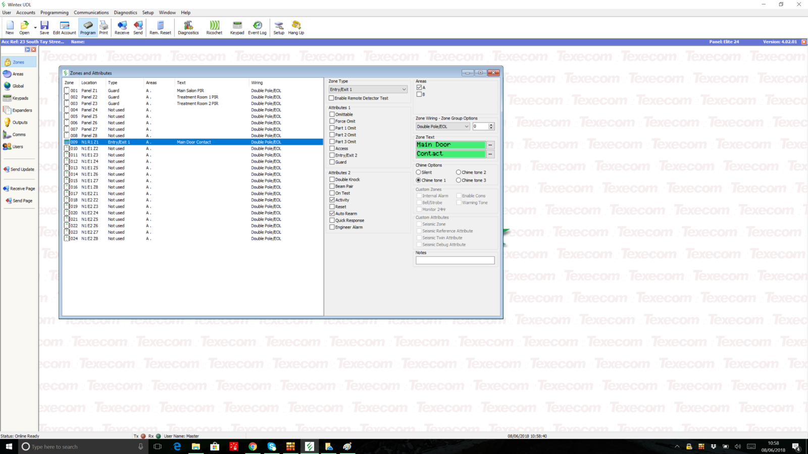

I have Wintex and trying to setup when main door opens it chimes as this is my little shop. I just cant get it to work. Have I missed something?
Here is the setup for the Zone
Please can anyone help?
Yes, press and hold chime button on keypad to turn the function on. Also double check Chime tone is enabled in keypads-keypad sounds
