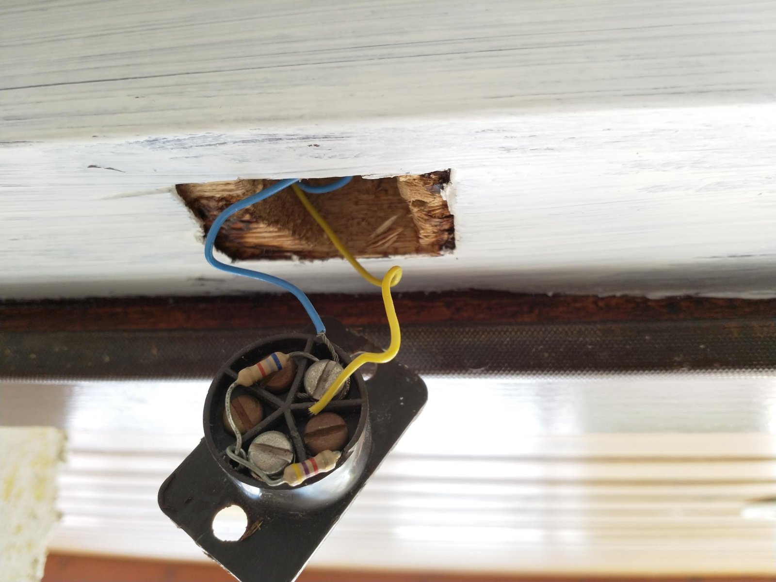

Hi,
I am in the process of swapping out an old wired alarm panel for a texecom elite 24. I have replaced most of the detectors with new, but was hoping to keep the existing door contact which is fitted into the door frame.
Does anyone have any idea how to wire the contact shown in the attached photo? i.e. which terminal to take the +ve, -ve, alarm in and out and EOL resisters to?
Any assistance would be gratefully appreciated.
Best regards
Andrew
Your old panel looks like a gardtec from the resistors ! Just make that zone use gardtec resistors ( no need to replace resistors)
Spot on, its was a Gardtec :). How do I make the zone use gardtec resistors? I'm struggling to find this in the settings.
Many thanks
Andrew
Managed to work it out :)
Program zone , e.g. 1 , keep pressing yes till it says , doublepole/ eol , press no, scroll down to 4K/6k (12k)
Press yes .....repeat on all zones you want to use the gardtec resistors on ....
