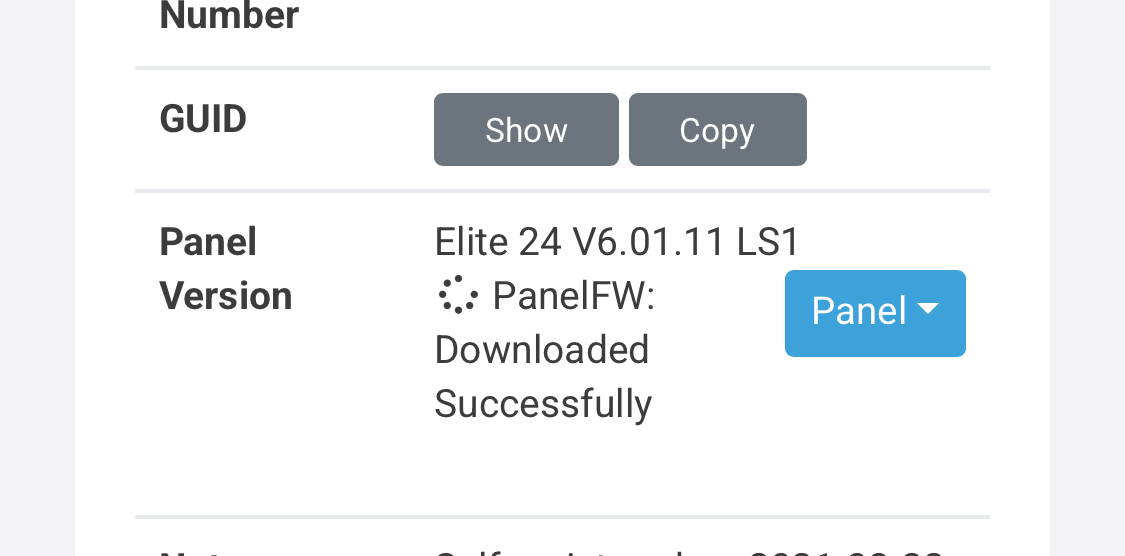

Updated my firmware yesterday and just checked and it has the following with the timer icon continuously spinning, any help on this please ? IMG_0359.jpeg
Alarm works fine just lost on what to do now, tried wintex and also logging in and out at the keypad
Any help on how to proceed with this please ?
Sorted went in via wintex and then selected keypad and put the code in and it reported the update so clicked yes and it installed, yet I tried this via the actual keypad and got no notification
Thanks for the help
There should be a user over ride option in the cloud so it doesn’t need a user to authorise.
only master user from memory can authorise the firmware upgrade.
Otherwise a user has to authorise the upgrade, I guess it’s a safety thing, ie no upgrade whilst user unavailable.
