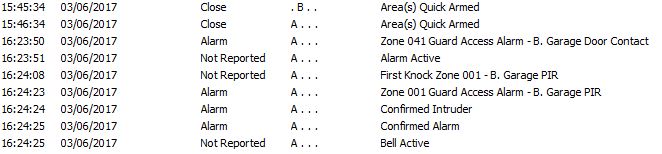

quick question to check why this entry time isn't working as expected in my garages.
so Area A is set as a Timed Exit, Entry 1 Delay Time and Entry 2 Delay Time are set to 120s.
Area A has a:
garage door contact set to Guard Access
a PIR set to Guard Access and to Double Knock too
a keypad
On exit I arm and I have more than enough time to get in car, open garage door, get out and close door.
On entry though, the alarm triggers before I can put in the code - it looks like it is being triggered immediately on the second time the PIR registers movement:
I have Bells on Confirmed Alarm and Internal Sounders on Confirmed Alarm enabled, so what I would expect is:
- if PIR only is triggered twice, entry starts but no alarm on timeout
- if door is opened only, entry starts but no alarm on timeout
- if door is opened and PIR triggered twice, entry starts and alarm triggers once 120s has passed
any ideas on which bit I have misconfigured so that the alarm triggers immediately after door opened and PIR triggered twice?
thanks!
