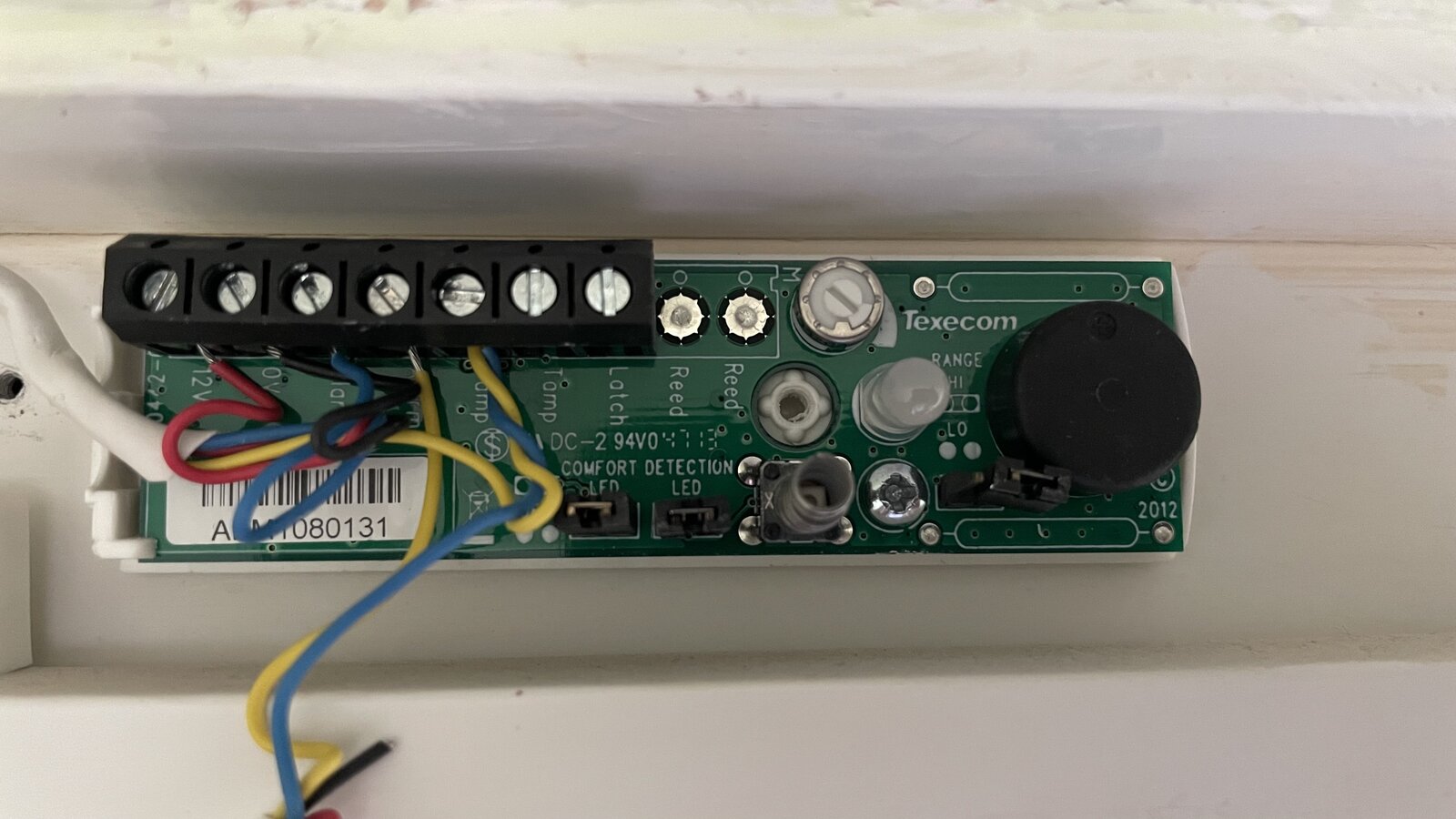

I had my front door changed so had to remove the old AEA with a magnetic reed switch.
When taking it off, I noticed that the cable was only 4 core. I want to replace the unit for an Impact SC but see that it requires a 6 core cable.
Did my installer make a boo boo with this?

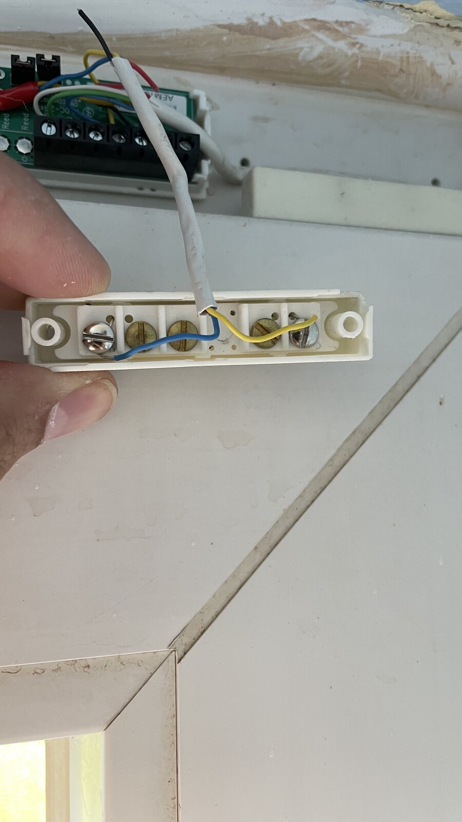

Image of original wiring.
Just to add, this is on the front door that controls the entry/exit trigger.

Ah! It has a reed contact…..just didn’t take a pic of it.
This…
Are you wiring Reed contract in series with shock?

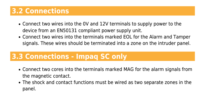

This is what is confusing me from the instructions -
'Note: The shock and contact functions must be wired as two separate zones in the panel.'
If the cable is only 4 core (2 for power and 2 for shock), what do wire into the mag terminals?
i spoke with texecom and they've said that i need another two cores to be screwed into the mag terminals on the impaq and then terminated into a seperate zone on the panel.......its impossible to run a new cable without taking up quite a few carpets and floorboards.....guess im going to have to go back to the external magnetic reed switch :(

I happen to have one in the office and can take a quick look and confirm wiring later today after I have checked a few things on how it functions.
how would you like it to work?
single zone for each contact and shock or combined onto 1 zone.
Combined into one zone.
That would be amazing if you can confirm.
currently its wired to share the zone.
This is good news, but do you have 4 cores running into the SC….that’s my issue. The installer only ran a 4 core cable to the door. Every other cable is 6 core.
