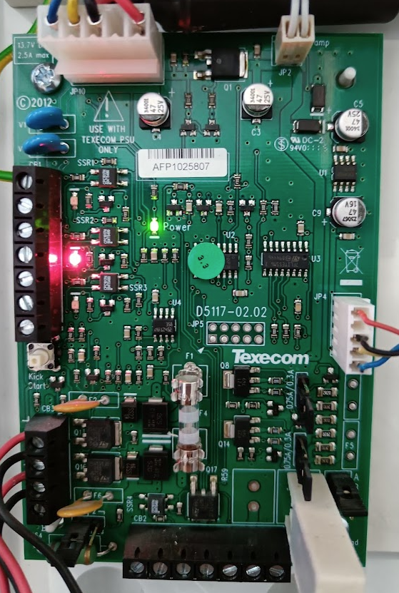

Hi there
I've got an Elite 48 panel and PSU200. Replaced both batteries but the battery fault light still appears on in the PSU200 (and battery fault on the keypads), even after a few days.
I checked the voltages - the panel battery shows 13.73V and PSU200 12.86V, both are brand new Yuasa 12V 17ah.
Is the 12.86V voltage too low for a new battery?
Actually just swapped them around, let's see what happens over next 24h

So I swapped the two batteries around and it's still "1,2" showing as the fault even after 24h+
Charging voltage is fine, both are already set to 0.75A
The mystery continues!
1,2 is the psu200.

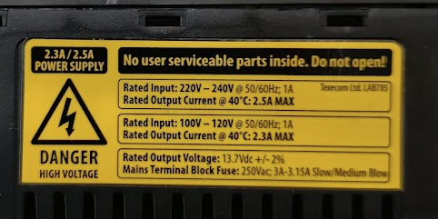

If that is all correct, then what is details on the PSU switchmode power supply -6 is the latest version and its possible there may be an issue with earlier ones.

Both ended up with the issue still being there - the red battery fault light appears straight away and the fault cannot be reset from the keypads like Tamper can
I am not sure what you mean by switchmode 6 - where can I check this?
first thing to check is which battery terminals is the 17Ah battery connected to, from the jumper selection it should be battery 1.

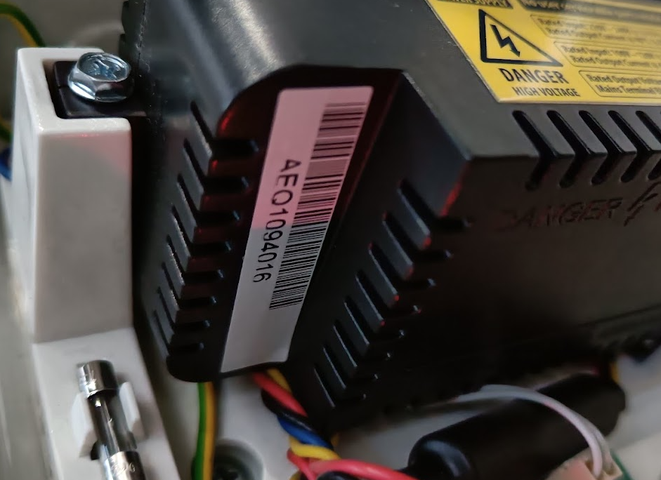

There is a white label on the PSU where it steps in.
Post photo of both bar codes on control panel and XP 200 switch mode power supplies.
Could be faulty switch modes as Texecom have had a big problem with the power supplies in the past and will depend on age of psu.

I bought the PSU200 in March 16, barcode is:
The panel was installed in 2013 and is not showing any power faults
could be a psu failure issue.
