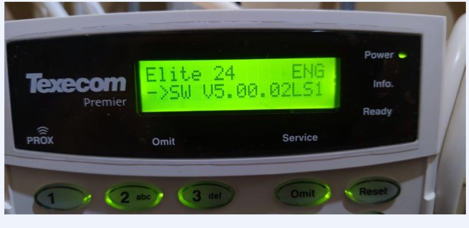

Thanks for that. My firmware is v5.00.02LS1. Would be great to know what other options are available. I was going to order something like this: Texecom Connect SmartCom Intelligent WIFI Ethernet & App Communicator CEL-0001 | eBay
Forgot to say, yeah I did the engineers reset last night and it was OK for a while, but come back after about 15 minutes. Maybe it is the poll that is triggering this?
it polls every 15 minutes and if it doesn't go through successfully it will generate the ATS fault.
Version 5+ Elite panel and a version 3+ smartcom should be fine, upgrade the smartcom firsts then the panels firmware
