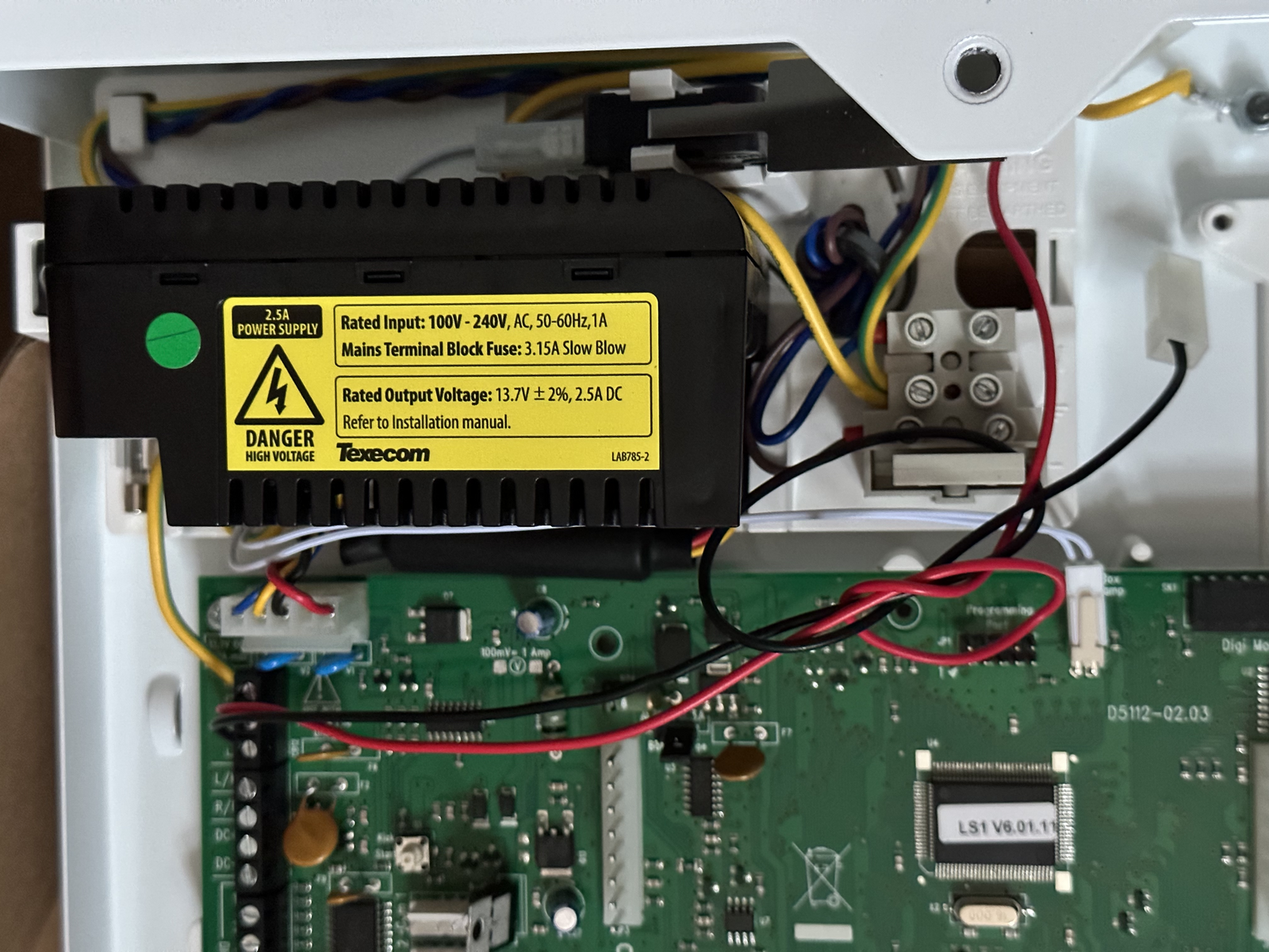

My Elite 48 has a black PSU (pic attached).

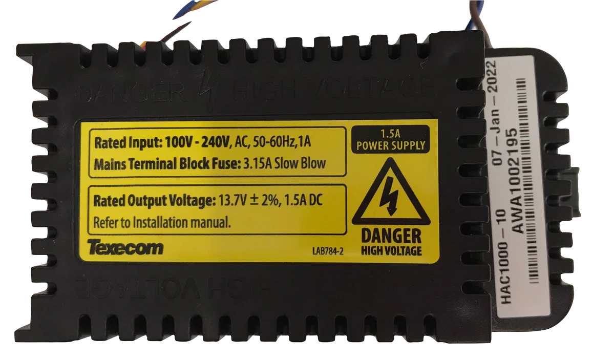

There is another label under that notch in the bottom left hand corner of the power supply which gives you the version number
On the one shown above the version number is -10 (as in HAC1000-10). Which version is yours?

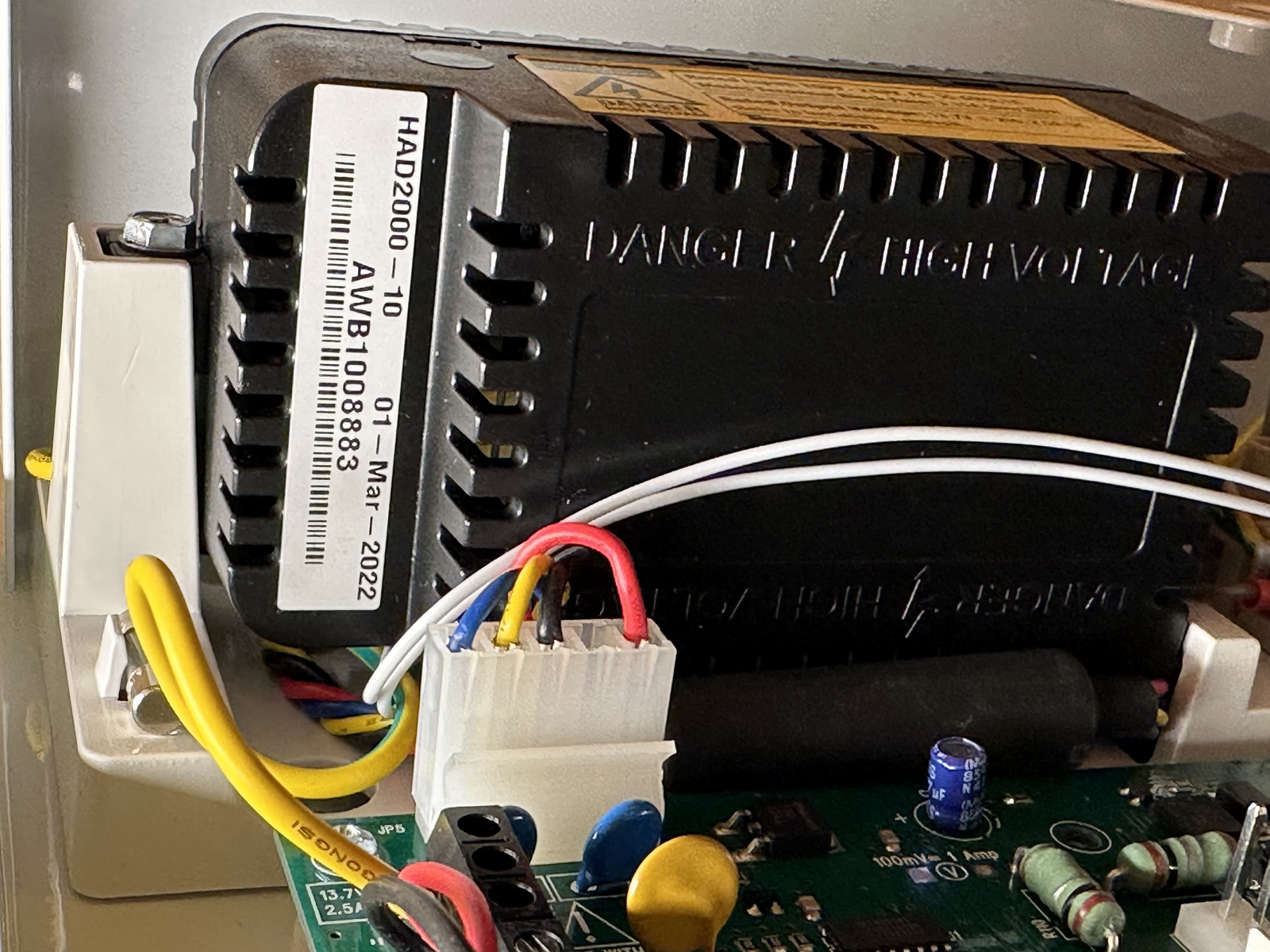

Ah thanks I didn't see that label. Mine says HAD2000-10 and date is 01-Mar-2022 if that helps anyone else out there. Will report back when I get my new replacement Elite 48 to see how that one behaves. It's a shame really as everything else apart from the 12v output is working perfectly!

The -10 version is a recent version, they are usually reliable but it is always possible to get the odd manufacturing fault. Let us know how you get on with the replacement.
