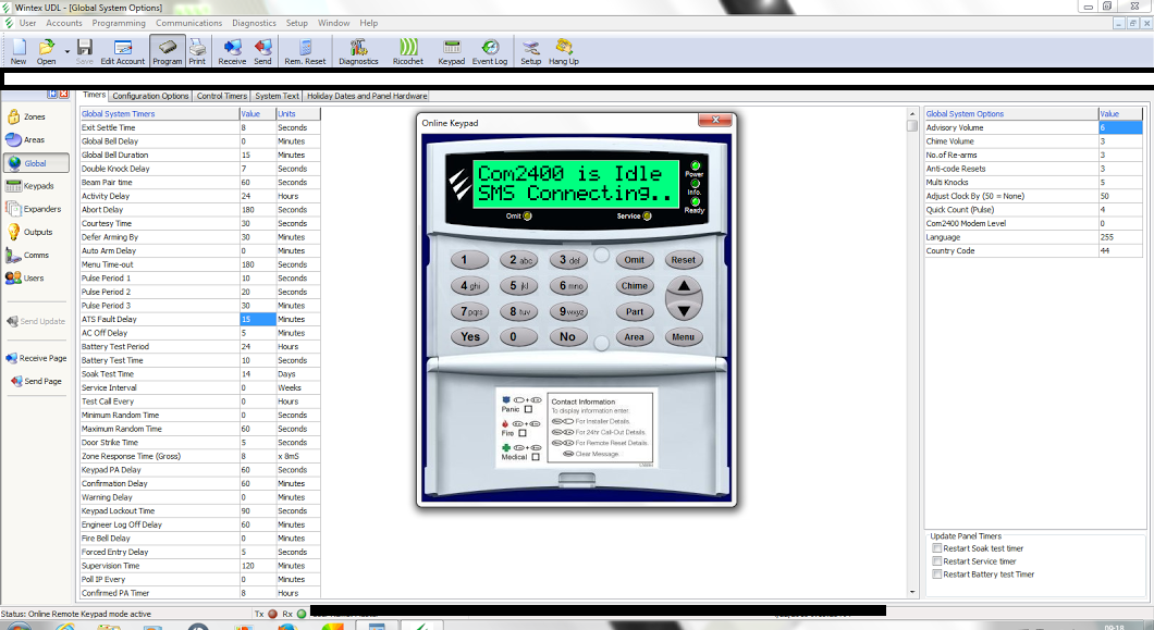

Hi Experts
I have a premier elite 48 panel (v 3.1) fitted with ComWifi on Com2 (working fine) and added the Com2400 directly to 10 pin connector and a speech module to the add-on panel as described in the manuals. Connected the phone line to the RJ11 socket using a ADSL filter from the main BT line. All after fitting in power down mode, worked ok and I see now Error message or alerts in the panel.
Setup all the settings as described in the manual for configuring DigiCom Options and Programming. Configured Arc1 as Speech module and Arc2 with SMS Messaging protocol.
When I do a test call the panel says no error as such and get the tone and all but I neither get a call on my mobile nor a SMS though :(
what I am getting is just below :-
Also, in speech module I recorded 4 different message on 1,2,3&4 but not sure how I assign the correct message to Arc1, Arc3,Arc4 and Arc5. Since these 4 messages are for 4 different people I want to assign Arc1 with Msg1, Arc3 with Msg2, Arc4 with Msg3 and Arc5 with Msg4.
I would really appreciate if you can please send me how to configure correctly and settings I need to use or if can suggest something from your experience.
Thank you very much in advance.
Regards
Anil

Hi There,
I am fine with the same message too. the way I want it to work is:-
1. The syetem calls the first Number and if there is a response (like # or *) it should stop dialing further.
2. If no response from 1st Number, then dial the second one... then third and then 4th.
If none of them respond then, send a SMS to primary and secondary number or may be to all 4.
I try to setup this up in the system and fortunately getting a call on my primary and secondary number.. and then for some reason again on the primary.. even though I accepted the call. But there is no recorded message is playing. I did record all 4 messages in the speech module (but not sure how to test if they were recorded ok or not).
Also, the system tries to send a SMS but keep failing after a long wait.
Anil
