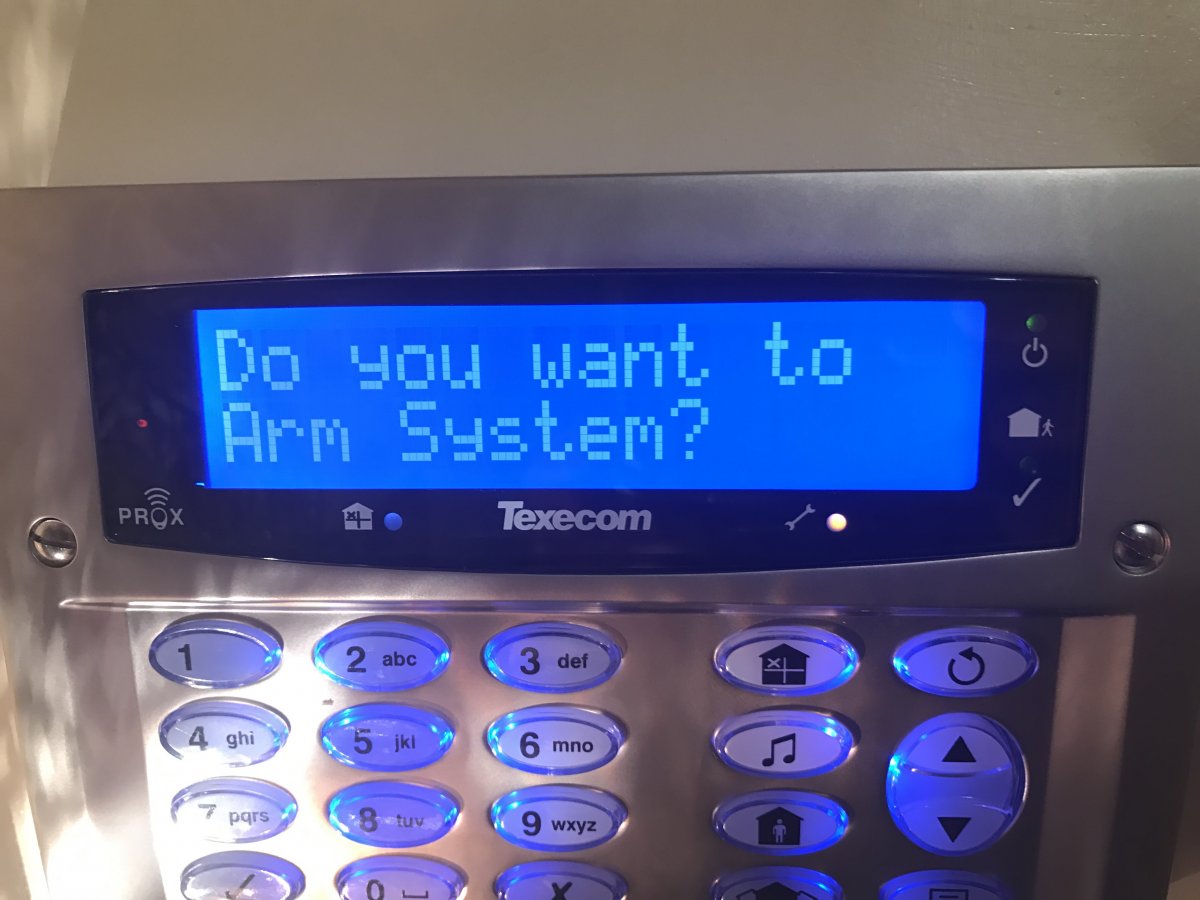

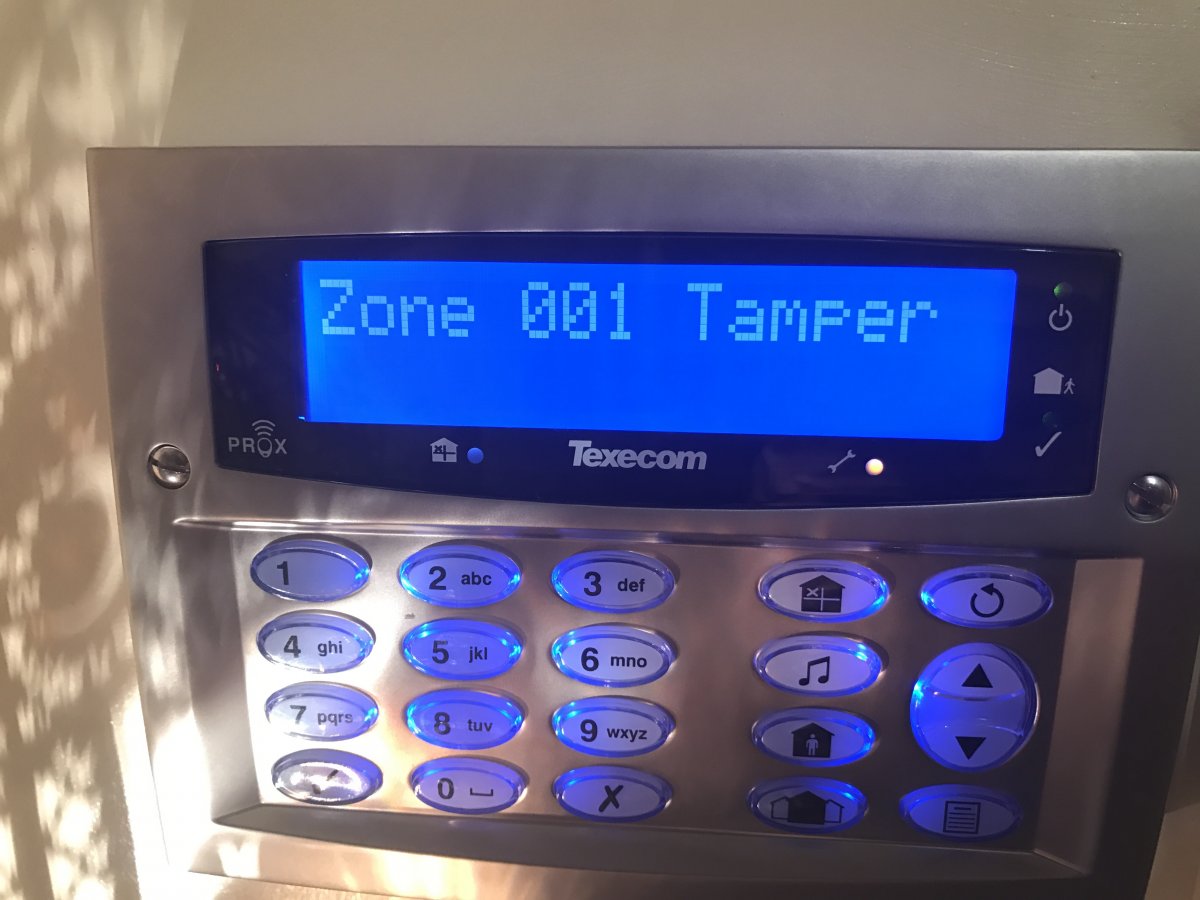

so I installed my texecom 48w into my house a few months ago preogrammed it in and everything has worked perfectly so far. Until today I set up the com ip to get access via my phone etc. After setting up the IP address and setting up the app I went to set the alarm.
When I got to set it just gives a beep and the service light flashes orange.. then when you go into zone status zones 1 through to 9 are in tamper. But these zones are programmed as not in use
It's not coming up with any faults either
So I'm thinking it is something to do with the com ip
Please help!

The zones will still show tamper even if nothing connected when viewed through Zone Status.
What messages show when setting the system?

Double check to make sure zones are programmed as not used
Go into engineer mode and then come out
Sometime service engineer comes on and just going in and out or engineering will clear message ?
It's doesn't show any message just beeps and won't set
Just worked it out what happens when you set up your phone it acknowledges and an external input device so you have to go into engineer mode and confirm it as a device
