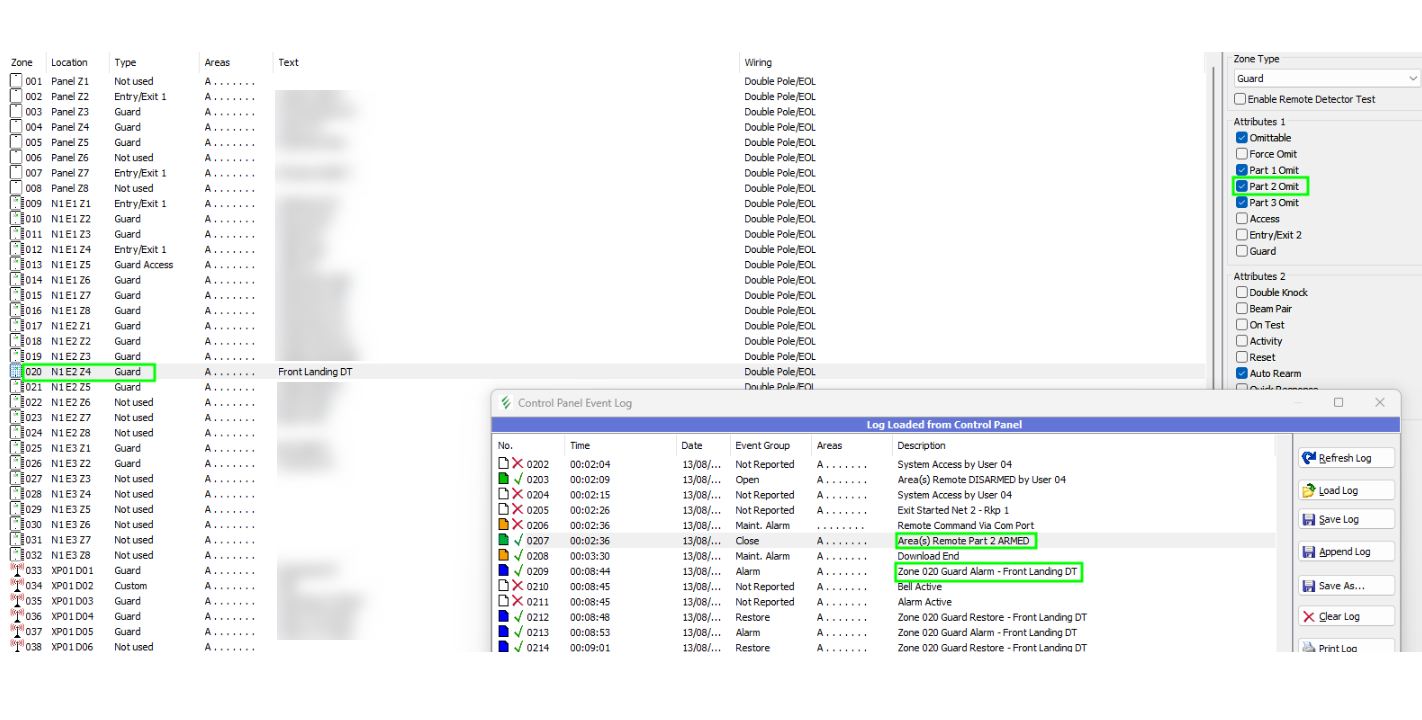

Hello everyone.
This is my first post so in case I did something wrong - please forgive me :)
According to what is on the screenshot - I excluded the sensor in Part 2 arming mode, and despite that it still activated. Can you tell me what the potential reason could be?
I warned you and definitely sent the settings to the panel, so these are definitely the current settings.
Thanks in advance for any tips.

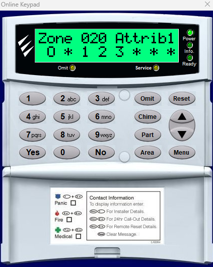

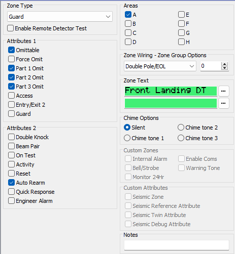

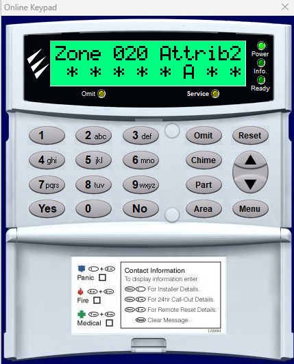

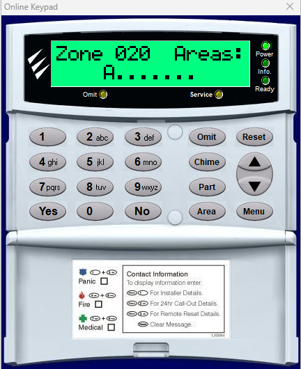

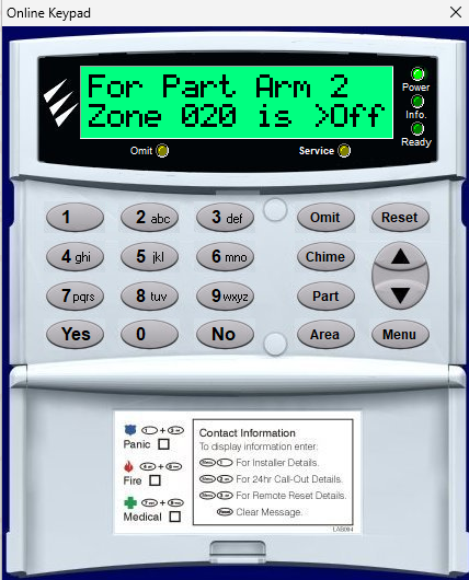

Confirmation of the fact the zone is not included in Part 2:
Sorry, I've simply misunderstood what you're asking for as I normally implement this sort of changes via uploading current page & I use keypad mainly for omitting & testing.
