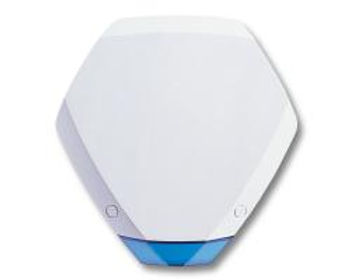

What batteries do the texecom bell boxes take. Its the same as the attached photo.
1.5V Lithium AA's but its in the manual, wouldn't use alkaline AA's they wouldn't perform very well.
