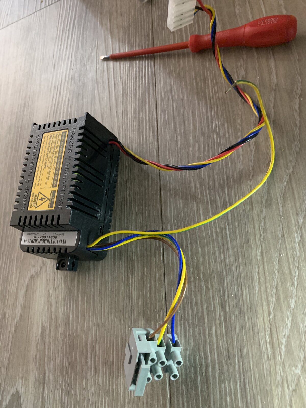

Hi,
I have received a replacement PSU for my premier elite 24 poly alarm.
The old PSU (HAC1000-5 / serial AUY) has an earth wire connected between the choc block and the psu and the psu and circuit board. inside the PSU the 2 wires are connected to the same solder pad and one side of a ceramic capacitor.

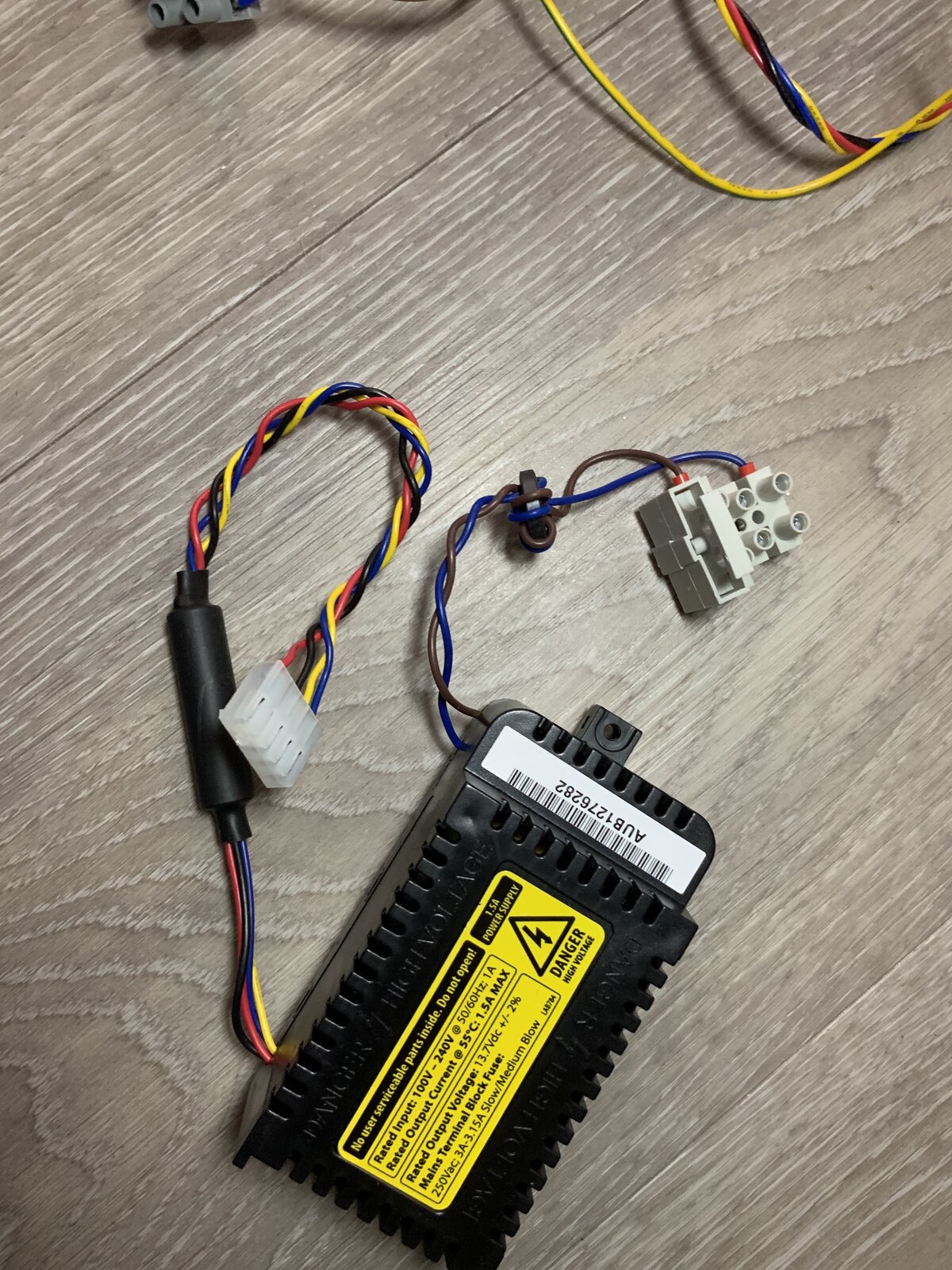

The new PSU (no HAC number / serial AUB) doesn't have an earth wire so I'm wondering if the earth wire is still needed?
Best regards,
Dave
ALL Premier Elite PSUs should have an earth wire between the PSU and the chock block. Don't fit a PSU without an earth. Can you post a picture of what you have?

Please find the 2 PSUs pics attached. AUY - original. AUB - replacement from Texecom.
AUB is older ! The earth goes from 240 input earth to earth terminal on pcb above the battery connection , I changed one the other day ...we had the older psu’s on the shelf
Ah, that explains it then, I haven't seen one like that. The latest ones should be like the first photo but HAC1000-6 rather than HAC1000-5
Thank you both that makes sense B being before Y!
I'll cut the earth wire off the old PSU and connect to the mains earth.
