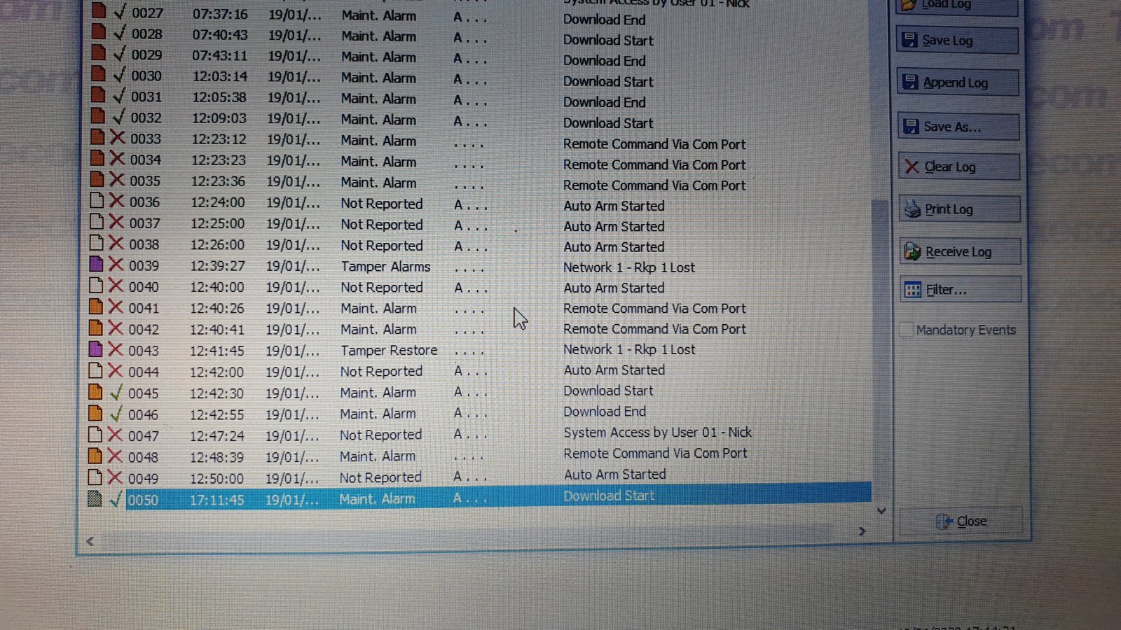

Hi All,
I m having a right nightmare with Wintex and setting my night timer.
Its simple what i need however whenever i set the times all it does is say Time Arming A......... lots of bleeps over the 10 minute test and then it just unarms and the log shows the set and unset but when i am tripping the DC and PIR the alarm isnt going into Alarm State.
Can anyone help me with the settings to set Area A full Arm from 23:00 to 06:45am the following day.
Thanks in advance
looks like you have other issues like losing your keypad.
do you know what was happening with that?
Don't see anything about system being armed or the zones being activated?
Are you wanting to automatically set the alarm during your time period without entering a code ?
If so set up in global control timers
Select on time and days required for area A
Select off time and days required for area A
don't see system armed or disarmed in that log.
see the arm starting bit that's all.
For testing purposes, I would set it up to start 5 minutes after you have updated the panel.
so if you post your timer settings, on and off time (screen shot),we might spot something obvious.
The system wont arm unless all devices in that area is secure.
