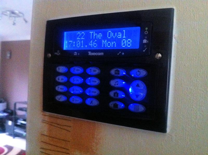

I am replacing a surface-mounted R8 keypad.
I was going to order the surface-mount Premire Elite keypad (Brass), but started to wonder about the flush mount.
Does anyone have any idea about how the surface mount unit looks? Does it have a "flush" appearance to it? (does the front cover all the sides/edges, or will it look like a box screwed on the wall?)
I am thinking that if there is a big difference, I could use my PMF to chop a recess in the plaster/new wallpaper (eek), and fit the flush one.
The specs just say 26mm vs 7mm.
cheers,
Carl
OK I found some pictures. The surface mount box looks good. I'm not sure it's worth the hassle to install the flush mount one, especially as I have just had it all wallpapered. Any thoughts?

OK sod it, why not. What's the worst that could happen (!) :D
(I am picturing my bad plaster disintegrating before my eyes, and my new wallpaper coming to pieces. No, it won't be that bad.. )
Well, I have ordered it all now! I started off thinking I was going to spend £41.99 on a replacement Veritas & LCD keypad, and I have so far ended up spending £300 on a Premier 48, flush mount brass keypad, a Com IP module, and a battery. Just need a couple of fobs off eBay now.

The supplier sent me an advanced replacement with a pre-paid return envelope, a couple of days after I posted above, so that's all good.
Unfortunately when I started using my Bosch PMF vibraty-cutty thing (great for skirting board and plasterboard..) for fitting the flushmount backbox, I quickly discovered BRICK behind the plaster. PMFs do not cut brick, as I found out.
So I had a learning exercise in chiseling brick.
I just finished up basic programming of the unit now after doing the wiring today (simply re-fitting existing wiring from the Veritas R8 ). Thankfully the battery is well dead in the bell box, since I don't have any ladders to get up that high, but, using just the speaker built into the keypad, it seems like it's all behaving as it should.
What's the reason for user-codes being defaulted to locked-out? (I had to change the "User 00 Locked by timer .....C" option, else I got "Sorry, code not allowed, use TAG" when trying to unset after an alarm.
I can imagine using prox tags is going to mean lots of scratches on that nice brass. I might stick tape over the tags.
Keypad looks pretty good. I will be redoing that bit of wallpaper (I replaced the lightswitch too and it's smaller than the old one), and flatting out the plaster around the backbox:
