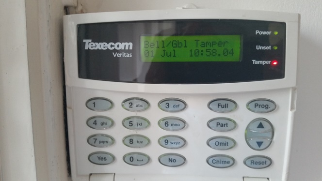

I got home today to discover a tamper fault on my Texecom.
full
I tried doing the latching walk test and it came up with a '......B......' on the LCD display. Not really sure what this means from the manual but anyway I progressed and opened up the panel. Below is the inside of the alarm panel. It was installed by the spark doing the rewire, a little over 4 years ago.

Well, i've tried this but the 'Tamper' light remains on. Does this basically put the tamper circuit at 0v and in theory clear the tamper? Anyhoo, it didn't work which has confused me as i'd assumed i'd negated the global tamper by my earlier test.
I have discovered that I can omit the tamper circuit from the alarm and so can at least still set it though I would still like to try and rectify this if I can. Presumably i've omitted all tamper circuits by doing this anyway?
Any ideas for anything else that I can try at ground level to sort this before either buying a big ladder or paying someone to look at the bell box.
Only other information I can add is this pic when I did the original Walk Latch Test:
full
I still don't know what the 'B' signifies

Just to confirm you have tried the link between black and yellow on the bell connections? not on the global tamper? Have you checked the extended log for cause of tamper?
Hi Deryck. The extended log just said Bell/Global Tamper
