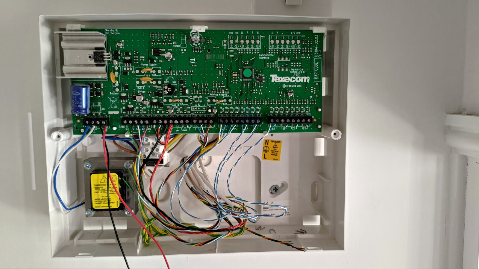

Hi All

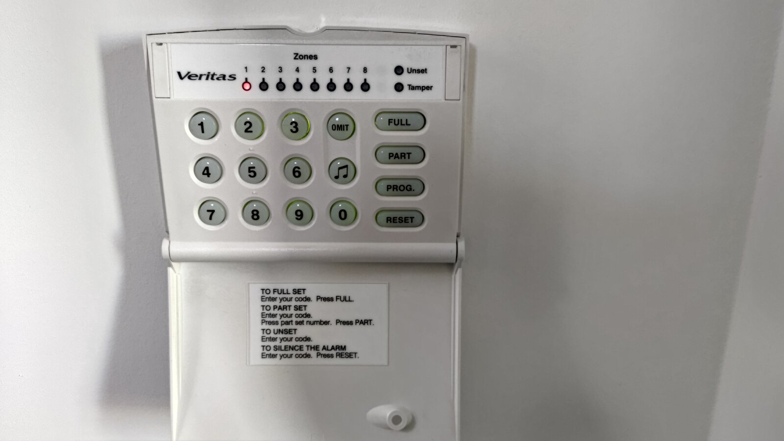

We have a Veritas R8 alarm system installed with RKP (CFC-0001 Hardware revision: 7 Firmware Version: 3.22) and there seems to be a problem upon first power up after removing the battery and the fuse to completely power down the unit (basically a factory reset)
The RKP is unresponsive. There is a solid red light on Zone 1 and whichever button you press it just does a single low tone beep and locks the entire panel out. The keypad lights are active (green illuminations from behind the rubber membranes)
The panel will beep 9 times in quick succession when the front cover is off. This indicates a tamper fault (as per the install manual) but the tamper light is not lit on the RKP
The panel will beep between 1 and 4 times randomly when the front cover is fitted. This indicates a zone fault (as per the install manual) and zone 1 is lit on the RKP. Zone 1 is a door contact and we have tried re-fitting the door contact and even touching both wires together to close / open the zone manually....no response
What does this mean and how could we fix this with an unresponsive RKP?
Thank you in advance
Default - Address 1
DIP1 - N/A
DIP2 - OFF
DIP3 - OFF
DIP4 - OFF
There is only this one keypad also (if that helps!)

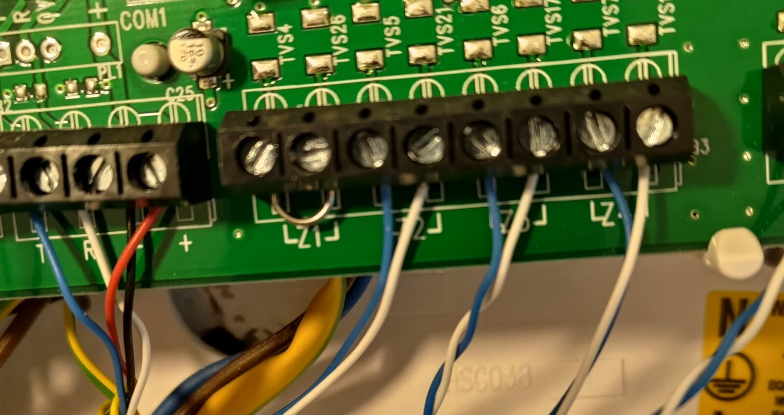

Whats the wiring on the keypad, sounds like there is an issue with the T and R connections.
just swap them round at the panel end and see if the keypad responds.

No difference with the T and R connections swapped around I'm afraid
random 1 -4 beeps suggests those zones are going active the keypad not respond at that point?
U tried linking out zone 1 in the panel to see if it clears then type in user code which may have defaulted when all zones are clear
I have unwired Zone 1 at the panel and used a bypass pin like this -
We still have the same 1-4 random beeps and zone 1 lit up on the keypad and its still locked out from any further input
