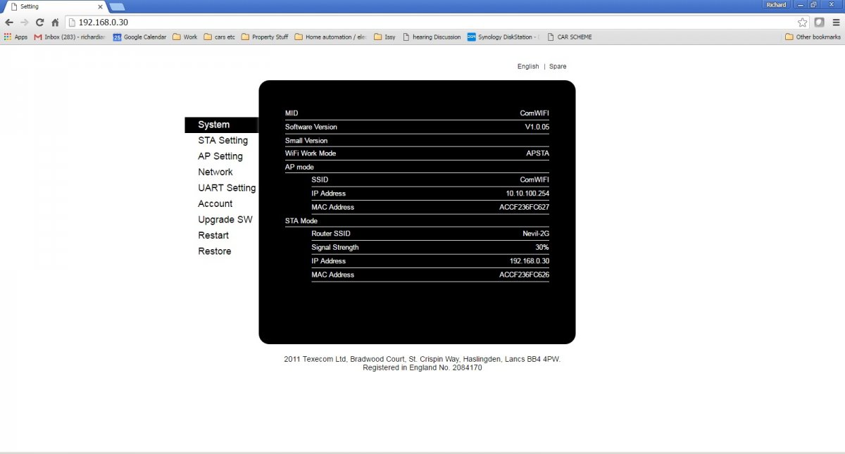

Hi
Firstly I have browsed many of the threads on this site and found some useful info along similar lines but nothing related to the wintex config.
I have never used Wintex before but would like to give it a go, I am having issues connecting and hoping someone can point me in the right direction.
I am connecting via Com Wifi.
This would appear to be configured, I have assigned a fixed IP, I can ping and I get a reply. When I browse to it's IP address I get the black splash screen (this is on my home network, not the ComWifi network you use to set it up).
I think I have configured everything on the panel as per instructions in the com wifi installation guide.

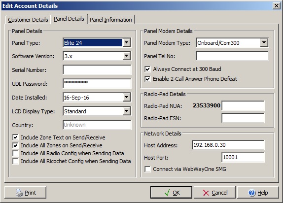

UDL password is set correctly.
W
hen I attempt to connect I see it says status is reading panel type and serial number, then I get the error connection with the control panel could not be established.......(serial number is not populated by the way).
Screen shot of browser and Wintex settings attached (hopefully).
Anyone got any ideas.....?
Thanks in advance.
Forgot to add, I have not modified the 'UDL Options', not sure if I need to. This is from the manual:
UDL Options
There are 6 UDL options that affect how and when access to the control panel via the Wintex UDL software is allowed.
Select options by pressing keys 1 to 6 (a letter on the display means the option is selected, a Dot on the display means the option is not selected).
The following UDL options are available
None of them seemed to apply - I just want to access via Wintex whenever I want.
The only way it wouldnt connect is it is somethings not set correctly.
So is the panel ip set up correctly
Ip address port number and udl passcode?
To start with.
