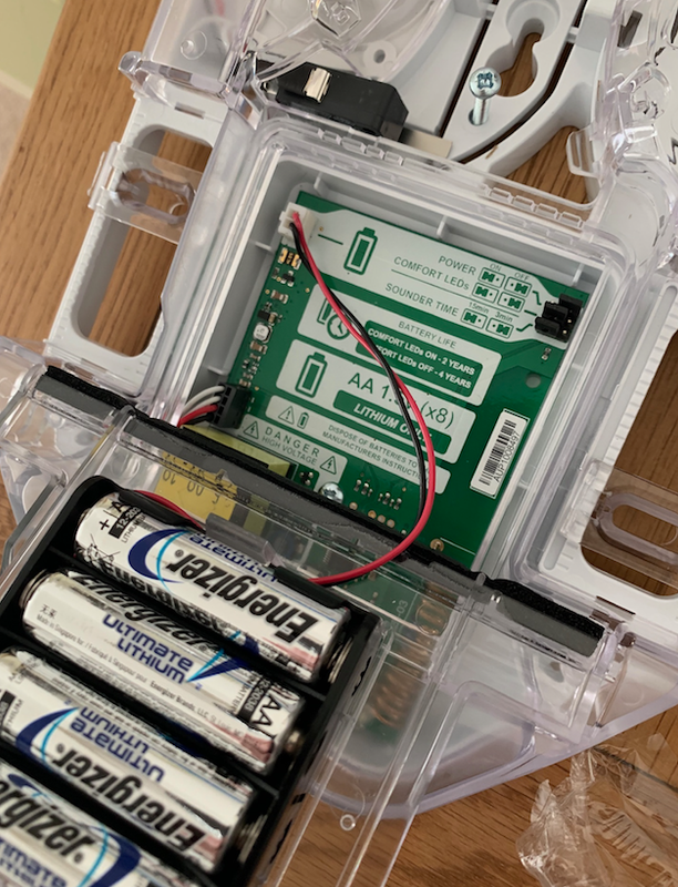

I can see from the instructions that you can potentially wire it up with 8 core alarm cable back to the control panel rather than use the 8xAA batteries it runs from.

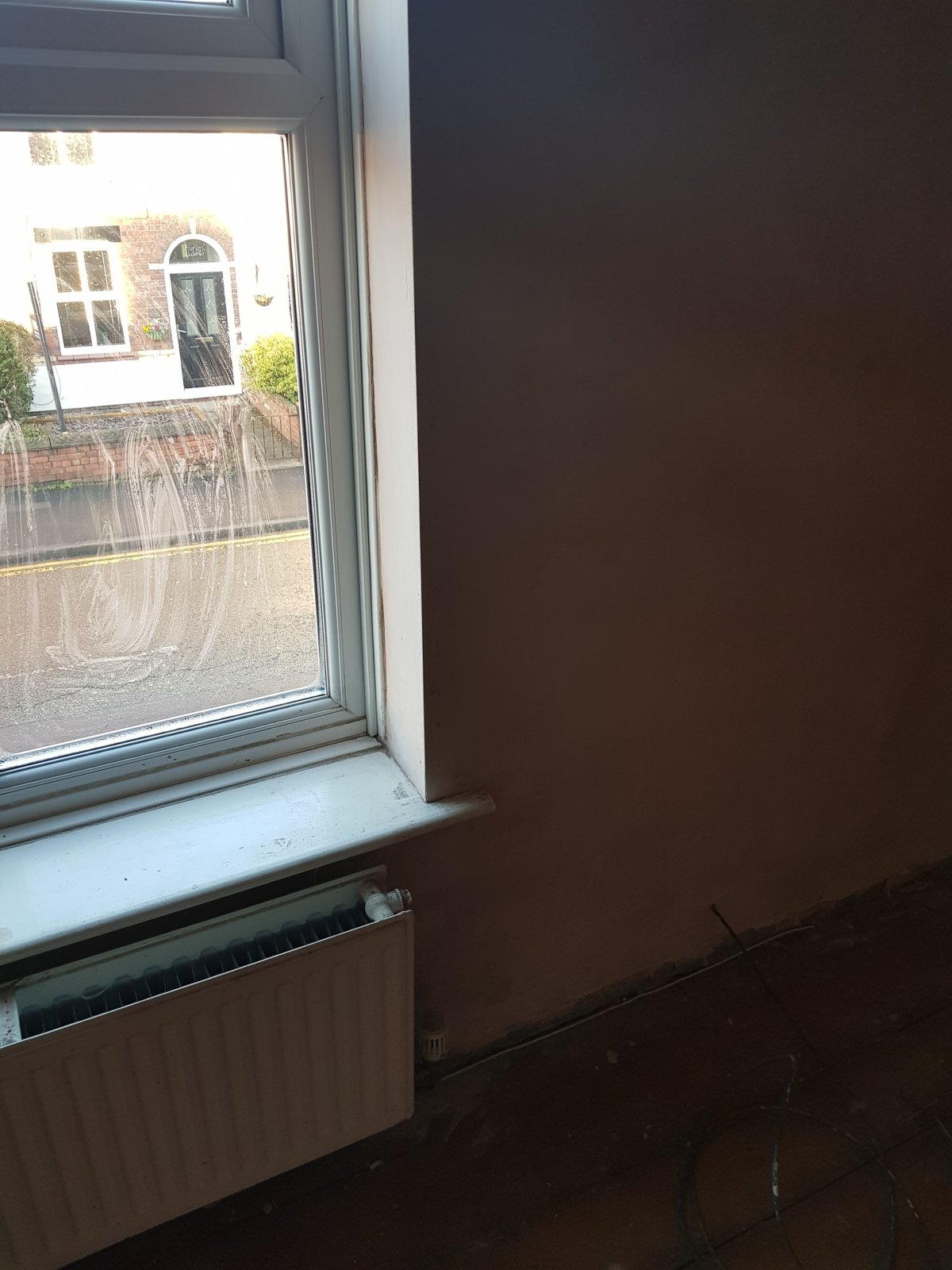

To be honest, the money isn't the big issue. Running a cable from the downstairs cupboard up into the loft is going to be almost impossible as the builders don't appear to have left any access holes and the plaster board is right up against breeze block meaning channeling would need doing. Will be very disruptive.

99% of houses will have some way of running in a cable. It might not go straight from A to B, but it's usually possible through use of built in cupboards, boxed in soil pipes, cavity walls etc. As a last resort, a bell cable can usually be concealed discretely up the side of a window frame etc. Here's one I made earlier! A bit of white silicone up the side and it's almost invisible
@HenryGregory - Yes you can wire the bell box to a mains supply. I contacted Texecom recently with the same question as i wanted to run the power for the bell box from a 13.8v alarm PSU with battery backup to save me the hassle of changing the batteries in the future, the bell box will be awkward to get to (albeit not impossible). Texecom said that would be fine and to just cut the cables from the battery pack and connect them to the power supply. I didn't ask about the warranty as I purchased my bell box through an eBay seller, its new but has obviously been in storage for a while. The cost saving was significant so I'm not too concerned about the warranty.

@HenryGregory - I used a PSU like this:
https://www.besafedirect.com/elmden...12-volt-dc-mains-failure-monitoring-html.html
https://www.cef.co.uk/catalogue/products/1626566-1a-12v-dc-boxed-power-supply-unit
I would go for an Elmdene unit if the budget allows as they are very reliable, google other suppliers as you will find them cheaper.
With regards your planned cable run make sure it cant be reached from ground level as if someone cuts that cable then your bell box is useless.

On Texecom wireless bells all it would do is allow the unit to function as a normal wireless bell and obviously the low battery warning would still function if the psu power dropped below the trigger voltage for low battery.
If you wanted to add a back light and have that controllable.
You could wire a separate 12V feed to the back light unit, and have a sensor wired in so that part would only function at night.
