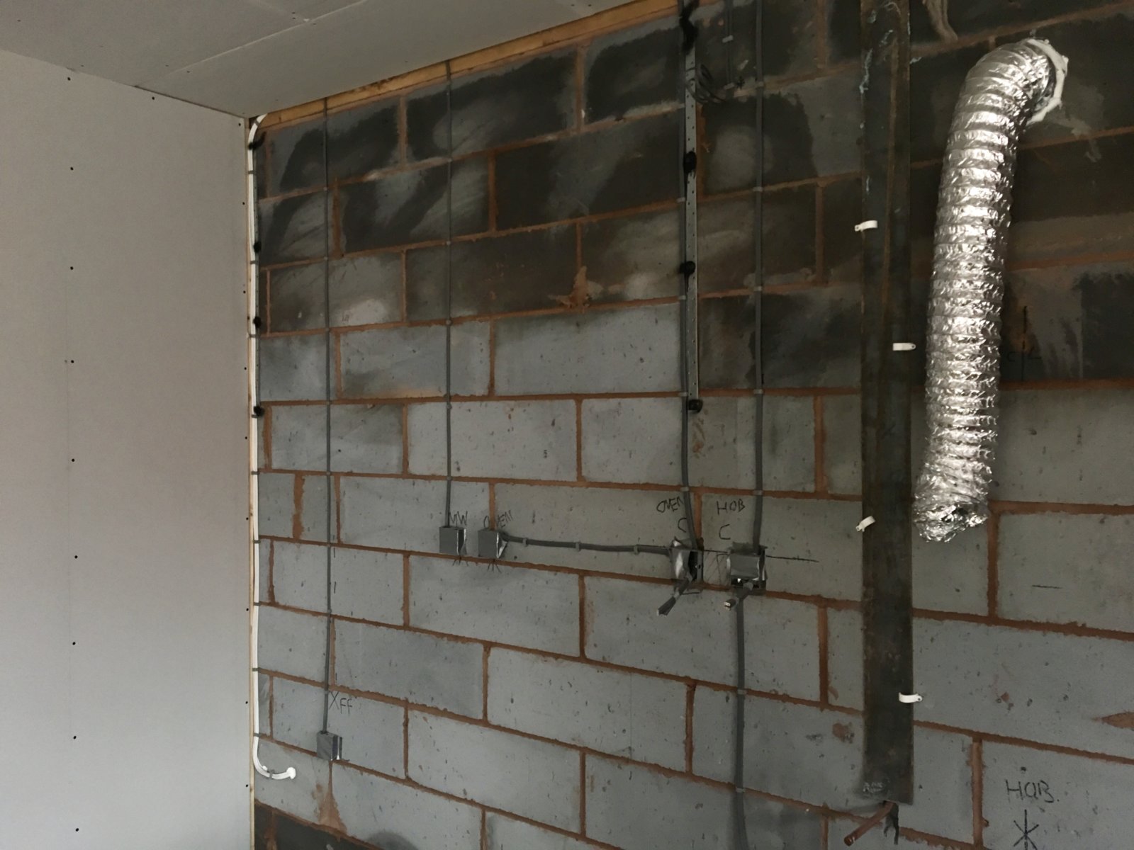

I was given a site visit and took photos.
From this this there were chalk wall markings. 'oven' looks to be a 6mm radial and 'Hob' (induction) an additional 6mm radial.
My interest was tweaked when I saw 'm/w' on one of the 2.5 cables from the 20amp grid switch back box.
Initially I thought the electrician thought it was a standard built in microwave oven BUT this is a 16amp 3,65kW combination oven with the same element and load of the matching single oven.
He confirmed he is aware of this.
So its unused and on the 2.5mm ring final protected by a 32amp MCB.

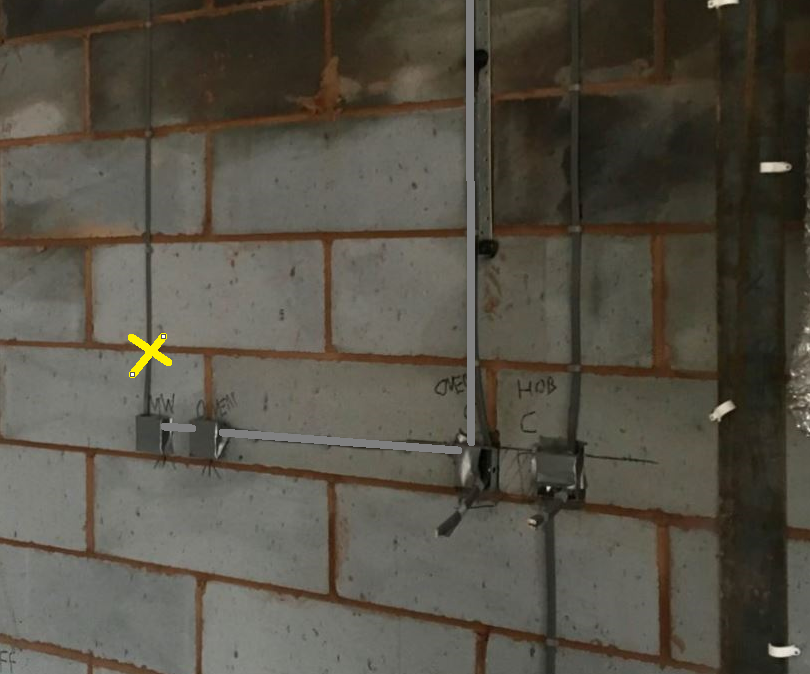

He is an image.
The chalk ident 'M/W' is for thee combi oven 3.65kW.
Hmm, can see how to load an image from a file on PC, any help?
Thanks for the replies again EFL.
To the right are the b boxes for the hob and oven.
To the left the b boxes for spur from oven radial and M/W from ring final.
These are exactly the same loads.

Well, the compromise is that he is going to put the second oven on another 6mm radial from the oven switch. Is this a better solution?
Its still not a 16amp device on a 16amp protection but the radial is well in spec. even if both ovens are on.

Agreed, but he's keeping the 2.5mm socket* and putting an isolating switch in the grid for it (unused but maybe in the future) but running an additional cable from the switch for the second oven and adding a connection point behind the oven.
*The plaster board is now over the wiring and it's being done as 2nd fix.
