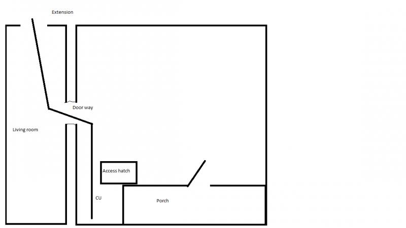

Anyway here's a picture of representation of what i've done. This picture is a looking down as if the floor was transparent. The bit thats marked doorway underneath there's a section of wall that's missing allowing me to crawl from the access hatch to the top left of the picture. There is a hole there where all the new cables are going. Took me bloody ages to get the first cable in. In the end I used my dads mini digger to brake through. Took me ages since the angle was really shallow. I will clipped it up onto the joists for the living room floor since it's really damp down there. Like I said the cable isn't straight run but slanted

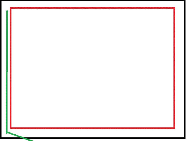

Also I wanted some advice on routing cables in the new extension. At the moment the wires are within a trench I've dug out. The trench is the border in the picture. The green line represents a wire. I was going to box it in with some wood then laminate flooring on top.
The diagrams are not that helpful, and if the cables where that difficult to pull through, I would be testing continuity, IR and inspecting them for damage, before I proceeded any further.
If in doubt blame a niceic electrician, I can live with that!
It's what us IT folks do. If in doubt blame someone else lol. so as long as I've not damaged the cable and I've clipped it to the joist, it doesn't matter have slanted the run is right ? the run of cable in the diagram is underneath the floorboards. The run is very slanted. isn't straight at all.

Your cable route looks fine. Under a suspended floor it doesn't matter what route you take. Just take the shortest route to save cable.
An odd clip here and there just to keep the cables off the sub floor is all that's required.
To the new extension:
If I've seen it correctly, then the ring runs around the perimeter of the room. The trench is a cut-out just deep enough for the cables.
Wood will go over the cable so that the floor and wood are flush
Laminate will be glued over this
No idea where ring enters room.
Thoughts:
Make sure that you have (more than) enough sockets. This is something you can't alter later.
Ensure vertical cables to sockets are clipped.
Check on the adhesive used with the laminate to see that it is OK with PVC. If not you'll need to protect exposed cable during installation.
Do all the tests you can before putting down the flooring
