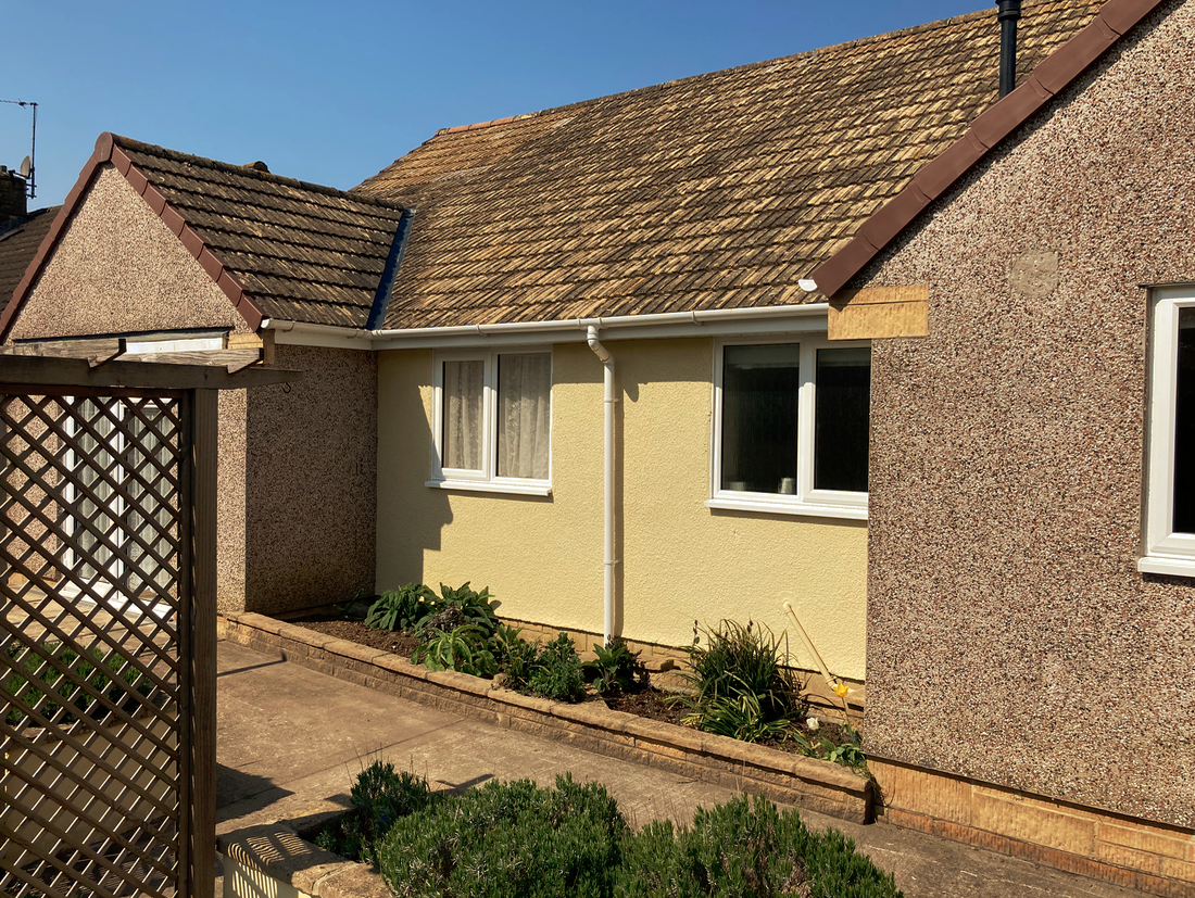

Hi,
Have read a number of threads on here where a single story flat roof rear extension on a bungalow hits the issue where the upper face of the flat roof is classed as the new eaves height, therefore will normally be above the existing eaves height and therefore full planning is required, but anyone had any successful ways around it?
I get why planning laws are in place but this does seem a bit daft where bungalows are concerned. Even more daft in my situation as neighbours and boundaries are nowhere near and won't even be able to see what will be a fairly small extension nestled in between 2 existing gable ends - see photo where the yellow wall will effectively come out 4 metres rearwards from its current position.
A pitched roof is bulkier, higher and more unsightly to some but would be allowed under Permitted rules (within reason) but I'm reluctant to do that as it would look too busy between the 2 gables. I am just starting pre-planning chats with the Council to find a way forward but get the feeling they are struggling with workload / Covid implications and have even less time to even consider being practical so I'd rather present them with a solution than hope they give me one - so has anyone successfully come up with a way round the eaves issue ie putting a small sloped roof section on the front of the flat roof to create some lower eaves, or maybe a gulley between the flat roof and bungalow etc? Not keen on dropping floor and ceiling down to bring everything down. Any thoughts appreciated.

Sorry, not quite with you - the only reason we see we can't proceed under PDR's with a preferred flat roof is the potential eaves height infringement, which is going to be around 380 mm over - which we are looking to find a way round with Pre-Planning advice.....which would be a planning issue would it not?
Bungalows do throw up this conundrum because if there were any other eaves higher up on the property elsewhere, say where a mini roof section or balcony with eaves had been previously formed elsewhere, then the highest eaves can be used as the maximum height and therefore my proposed extension should sail through under PDRs.

But it is if you look in the Technical Guidance as to how they define 'eaves height'.
Could something like this work, with a 'dummy' eaves with 2 courses of tiles? Wall plate at the same height as the existing wall plate, so technically the eaves would be the same height as the existing eaves.
The flat roof and dummy rafters could be supported on one timber beam each side; fiddly, i know; it would be easier if the outer wall was a straight gable.

Convert the window to a door and then build a porch under PD. No eaves restriction on a porch - just overall height of 3m
