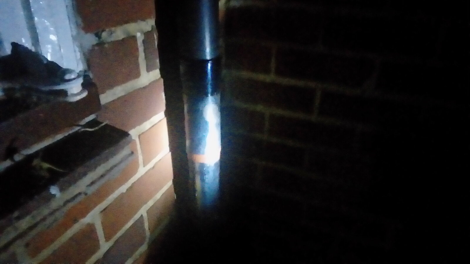

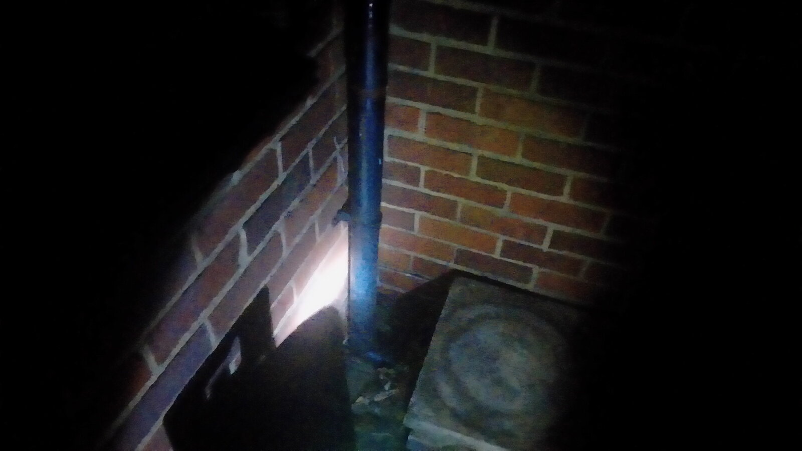

Job done ! I put a piece of 68mm over 63mm pipe with weld cement. Further sealed it with some old mastic. Left enough 68mm pipe above the joint to take a 68mm m/f joining socket. The downpipe goes into the socket, with a little adjustment (cuttin P_20200926_221708.jpg P_20200926_221648.jpg
You can see where the old water butt stood on the raised slab.
The 68mm is quite a loose fit over the 63mm pipe so needs to be held in place while the solvent cement sets. Hence the extra matic seal just make sure , a few hours later.
