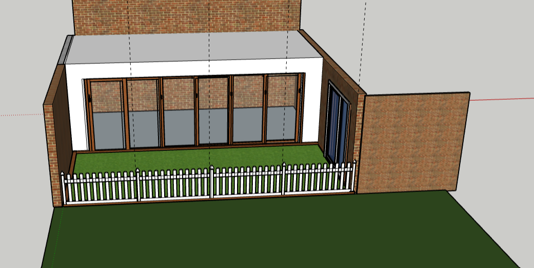

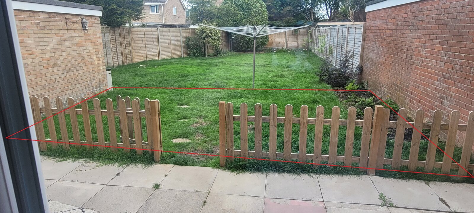

Show the backyard size I have to play with, the fake grass area (red box) and my start of SketchUp for Project 1&2
In the SketchUp the White building is the (start of) the extension, and the fake grass is between that and the white picket.
