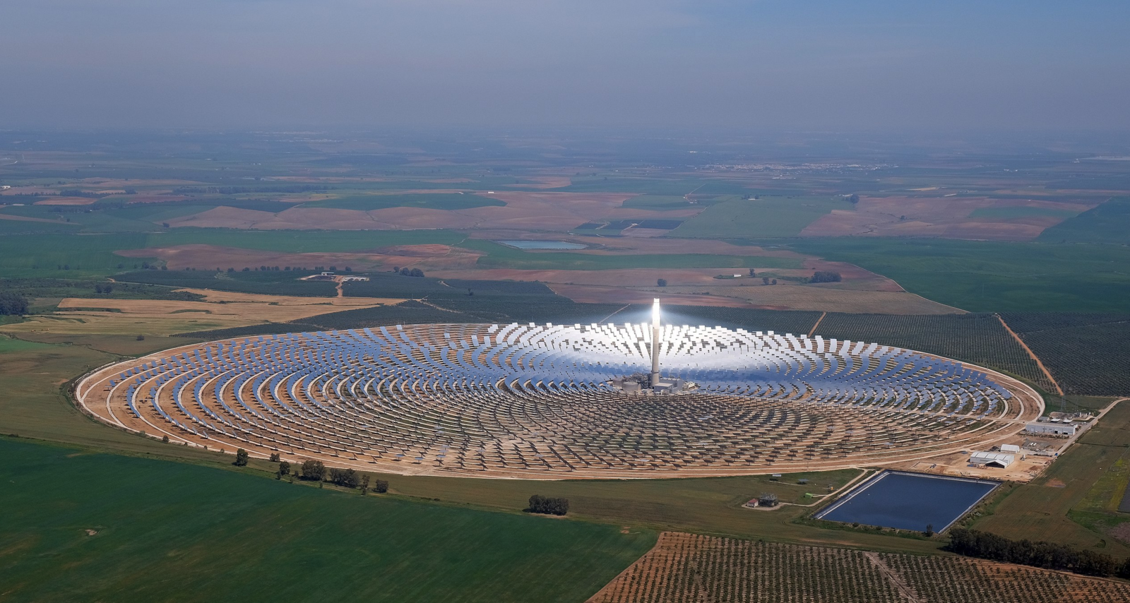

So focus your 10 sq m of lens onto a 1 sq m of panel and you'll get some heat, but payback might be a way down the road and (crucially here) 1 sq m of lens will not capture 10 sq m-worth of energy.
Of course some do this on a big style (Gemasolar Thermosolar Plant, Spain) :>
But they are melting salt to store the heat to drive a turbine so not applicable to home use.
