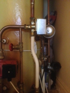

Sorry, Im a new poster, but I have posted two pictures that might help.
No sure if this shows any blender? I can see something that looks like a mini expansion vessel (silver thing level with the motorised valve) and the brass fitting that is shown on the 1st pic that has three connections, but I don't know what it is.

That does look like a thermal store to me. The blending valve is in the top pic and has a brass cover. What temp is the boiler stat set at?it needs to be near to max.

There is a blending valve on your thermal store, you could have a cylinder full of hot water but faulty blender will stop the hot water, do you have any way of checking how hot the water is coming out of the cylinder ?
I'd be inclined to await your plumber's return. This certainly looks like a thermal store, and the hot water will be provided through an internal heat exchanger. If the store is up to temperature, and you have little hot water, I would suspect the blending valve, Which is the three port valve adjacent to your temporary thermostat. Normally the heating would be provided from the thermal store, and not direct from the boiler and I would think it probable that the 3 port valve is only a bypass for when the store is up to temperature.
