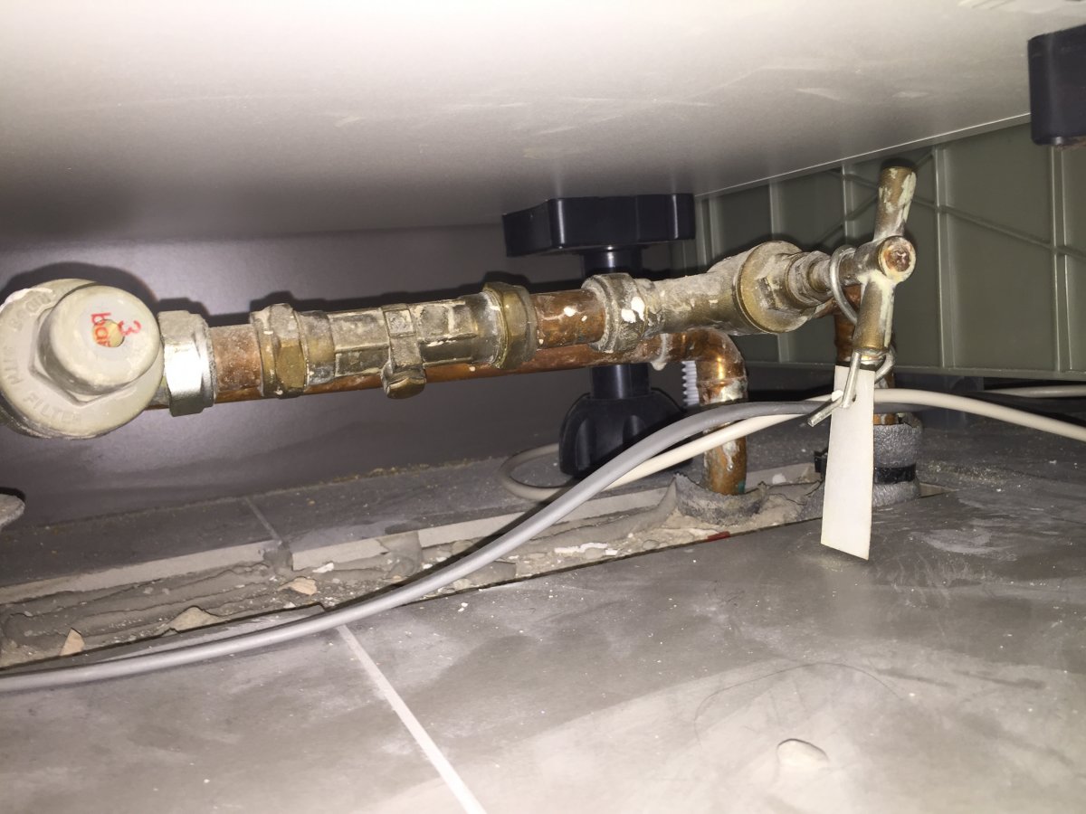

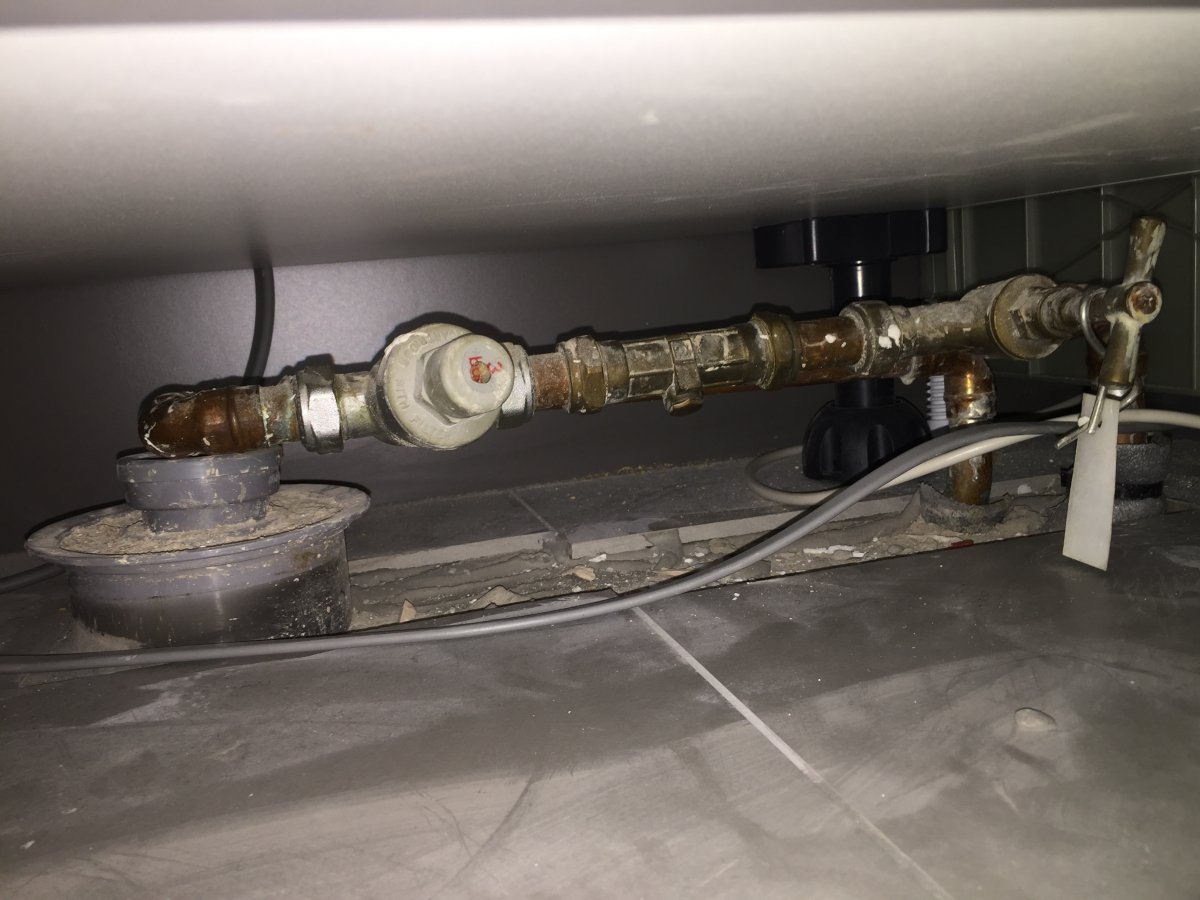

Cheers for the reply guys. I'm not sure if any of supply pipe work has been reduced. I've attached a couple pictures of the incoming supply, as you can see it's a concrete floor. This was excavated out to re-route the incoming supply to the island location. If anyone could tell me if it all looks ok here?

If the pipework was 22mm before and they've reduced to 15mm that will have an affect also.
Loads of fittings and valves = pressure drop.
If the main stopcock is ON fully, then it's likely to be 1)shyte in a filter or 2)the pressure reducing valve on the blink, best replaced.

The visible pipe work at the incoming mains is 22mm.
The two fittings at the thermal store below the expansion chamber were actually added at the same time as the mixer valve was replaced. There was leaks at the solder points on the pipe here for the incoming cold water supply to the store. It was attempted to solder the leaks but it failed so these sections were cut and the fittings installed. So these fittings could reduce the pressure?

could you take the pipe work off after the stop cock and put a pressure gauge on so you have a starting point and make sure the pressure is ok, then you could put the pressure gauge on the pipe work after the stopcock and see the difference, it gives you something to work from.
My guess would be that debris got into the pipework during excavations and reintroducing the supply has pushed this downstream to a bottleneck!
As stated above, check at various points where access and decoupling is feasible and flush out where you can.

Killy, yeah figures. I love how the floor tiles are cut around the 'prop' for the pipe!!.......:LOL::LOL::LOL:
Amazing how they relocated the stopcock to a more inaccessible location. Looking at these photos mate, you've had a right bunch of chancers in.

Certainly taking it into the cupboard would've been 100 times better!!!! For re-washering the stopcock & easy access incase of an emergency. I'm sure it'll contravene the Water Bylaws in that location, but hey you've checked the Plumber's qualification before he started.
You've ended up with 3 valves you're unable to maintain in an inaccessible location.
