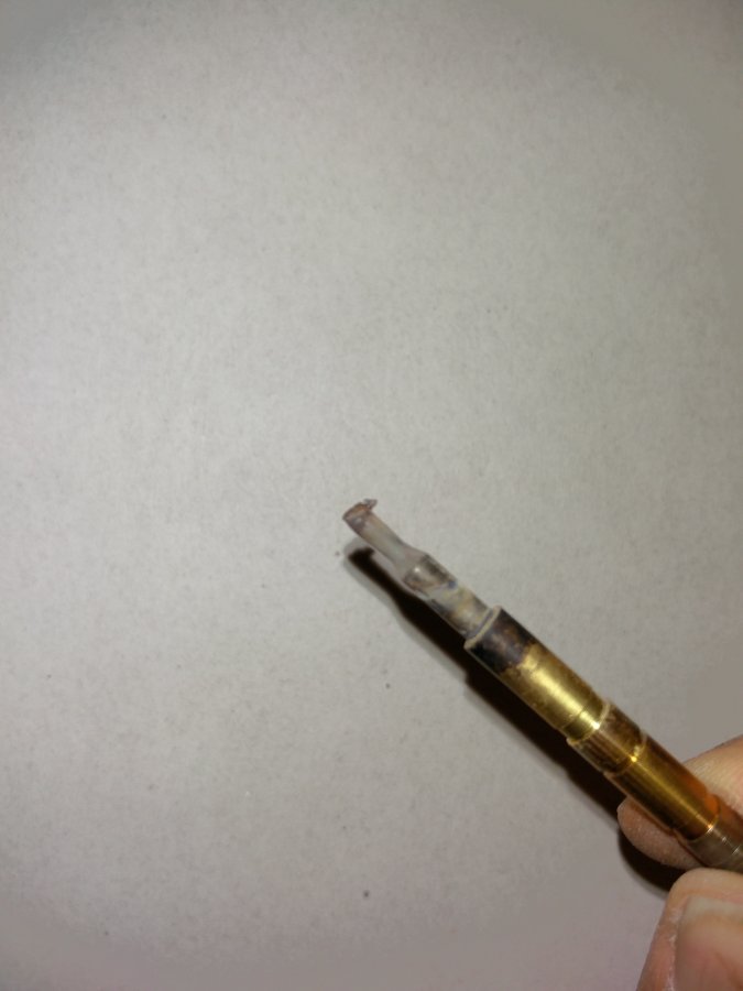

The old thermocouple attached. Seen better days.

That almost looks as if the flame is too big.
Its a balance between smaller flame and longer T/C life but with the risk of the pilot being blown out when its windy and a larger flame which will overheat it and shorten the life.
Many like the larger flame option as that will not get them blamed if it blows out and get them another job sooner!
