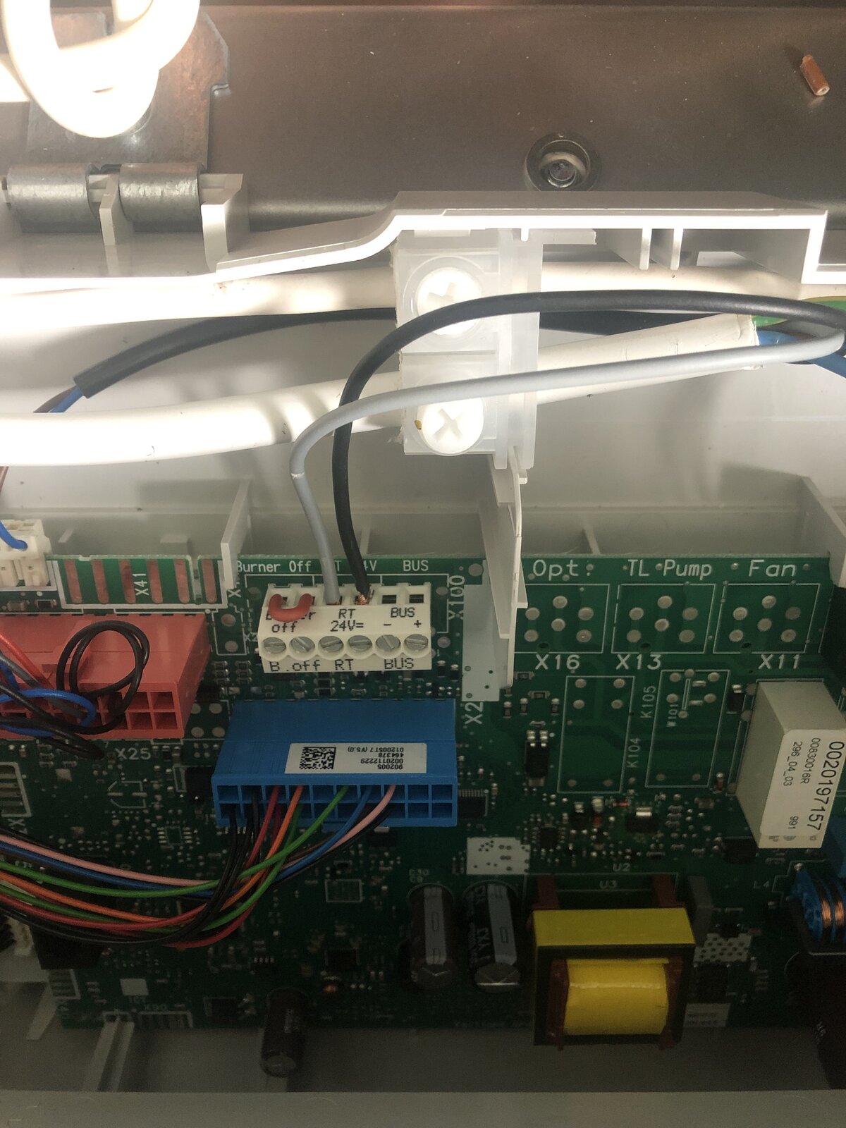

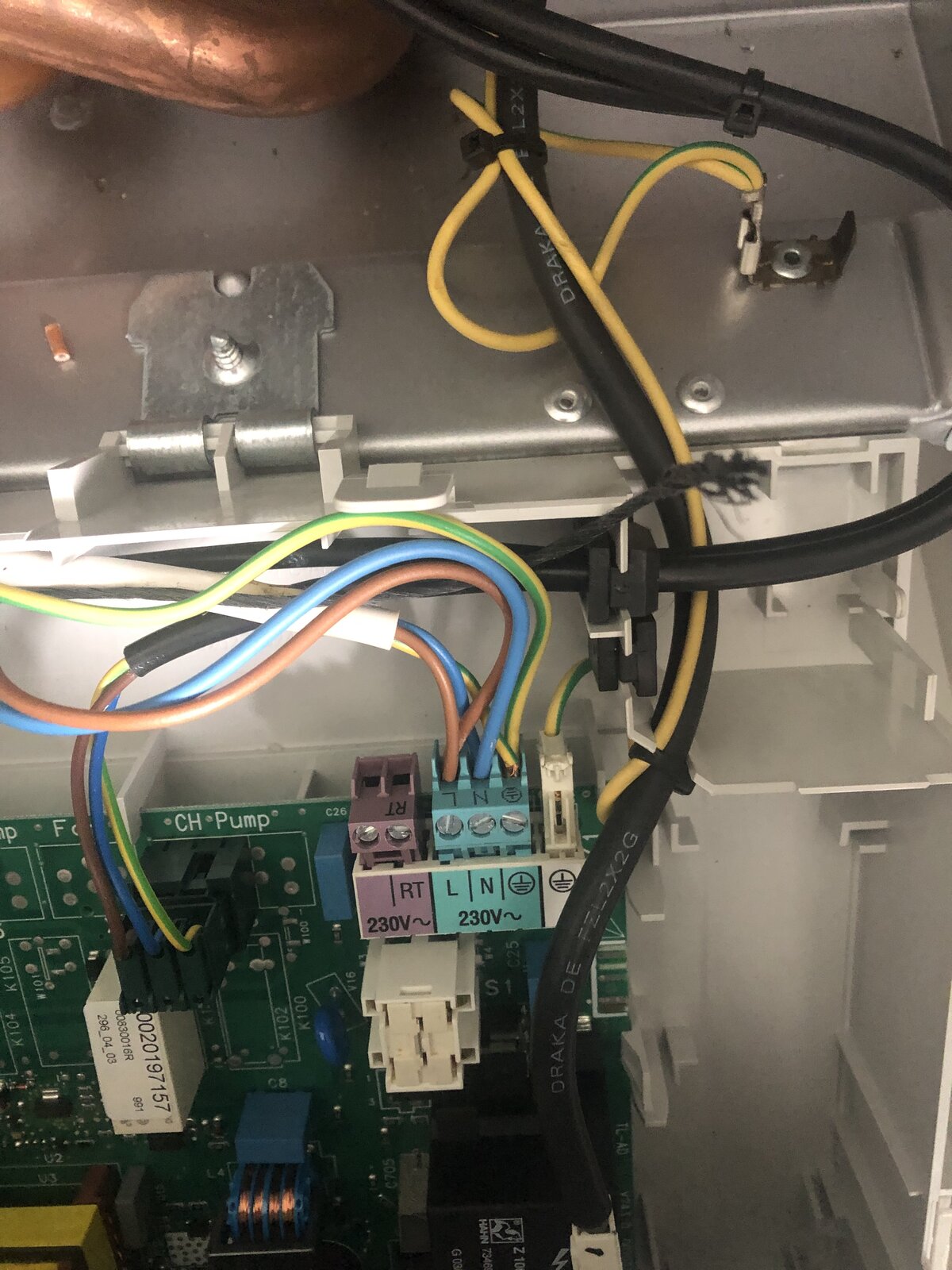

sounds like your Salus and your hive have been wired into the OT terminals on the boiler, they need to be wired to the on/off terminals
I’ve attached pictures of the connections. Let me know if this is correct please.

I see the Bus terminals not used, so not using OpenTherm, so it uses the return water temperature to control boiler.
So the wall thermostat has just one job, turn off heating on a warm day.
So location is really important, it should be in a room normally kept cool, with no alternative heating, on a lower floor, with no outside doors, don't know your house, but my house not such room.
So we move to near enough engineering, which often means wall thermostat in the hall, and the TRV set so only on warm days will the central heating turn off.
This is nearly manual control, and selecting on/off depending on weather conditions will likely do the same.
Main thing to remember is the TRV is king, using as I do 9 programmable TRV heads no room will over heat, and as they close, the boiler auto turns off, or with a modulating boiler turns down. All the wall thermostat does is stop boiler cycling in warm weather.
