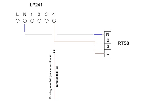

Hi, kind of a noob so please be gentle!
Basically I just wondered if anyone could help with advice on fitting a Drayton RTS8 with my Lifestyle LP241.

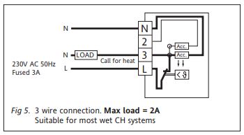

The thermo says it's either 2 or 3 wires, Baxi seem to recommend 3 wire fitment, the LP241 manual only seems to show 2 wire fitment.
So the questions I had were what do I connect to where please, what wire do I use (normal mains wiring or is that overkill?) and it's going to make things a lot easier if I can fit the thermostat upstairs as that's where the 241 is, is it ok to just have a thermo upstairs?
Sorry if these seem obvious, I'm fairly competent with diy but this isn't my area of expertise ;p
The wiring depends upon the type of heating that the thermostat is fitted to, as you seem to have a boiler, the installation method is to use 3 wires, as per the RTS8 instructions below.
If I have read your post correctly, it would appear that you have an existing LP241 and you don't have a thermostat, so wish to add an RTS8 to it. If so, you need to break into the existing wire going to LP241 terminal 4, and reroute it via the RTS8 and add a neutral connection to the RTS8. I have sketched this out for you below.
The wiring colours may not be applicable for your installation, but I have used them just show what is connected where. If the wire used as a neutral isn't blue, a bit of blue sleeve at each end can be used to identify it as such. Obviously I haven't shown the other LP241 wiring only the bit that needs changing. All other wires remain as they are.
Usually the three core and earth sheathed cable used for 2-way lighting circuits is used to wire a thermostat. The thermostat is operating at mains voltage so mains wiring is not an overkill, it is essential.

If you are unsure about anything, or I have misunderstood what you are trying to do post back.
