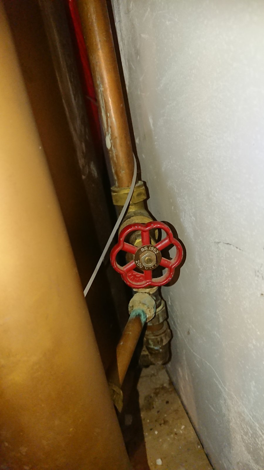

mine is a gravity HW system and has no thermostat I take it!!
must a an airlock as the hot water cylinder does not heat hot just warm when oil heating is on for 2 hrs or so!!

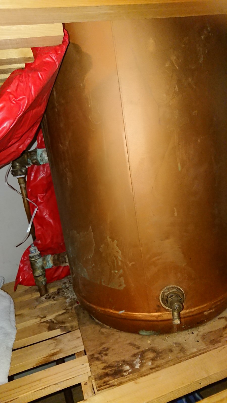

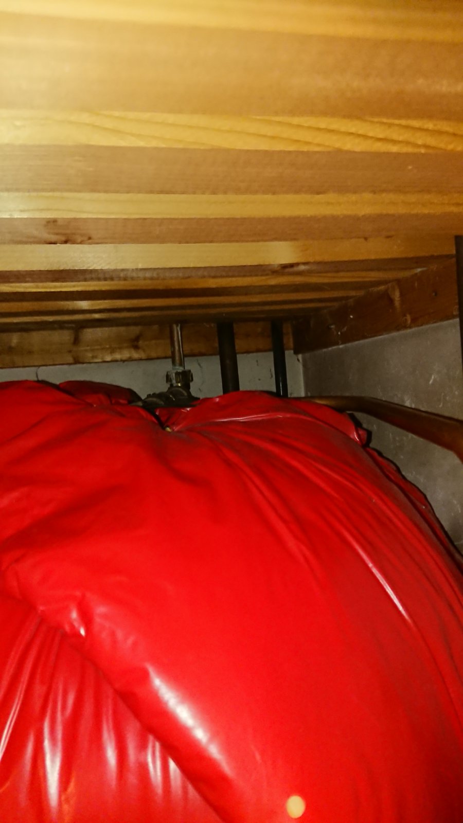

Cylinder will not heat just from central heating, Gravity maybe different. Take and upload a photo of cylinder and any motorised valves. Do you have a programmer?
Yes programmer works twice a day

Yes there's no thermostat on that cylinder. Depending on which zone valve setup you have, it's probably not sending the water to the cylinder

Hard to tell in the photo, but the pipes supplying the hot water cylinder look to be 15mm to me.
If that's the case, for gravity circulation 28mm pipes are normally fitted. So, are you sure that it's gravity circulation? and if so has it ever worked?
I have a water tank in the loft above the hot water cylinder and a pump at the heating boiler

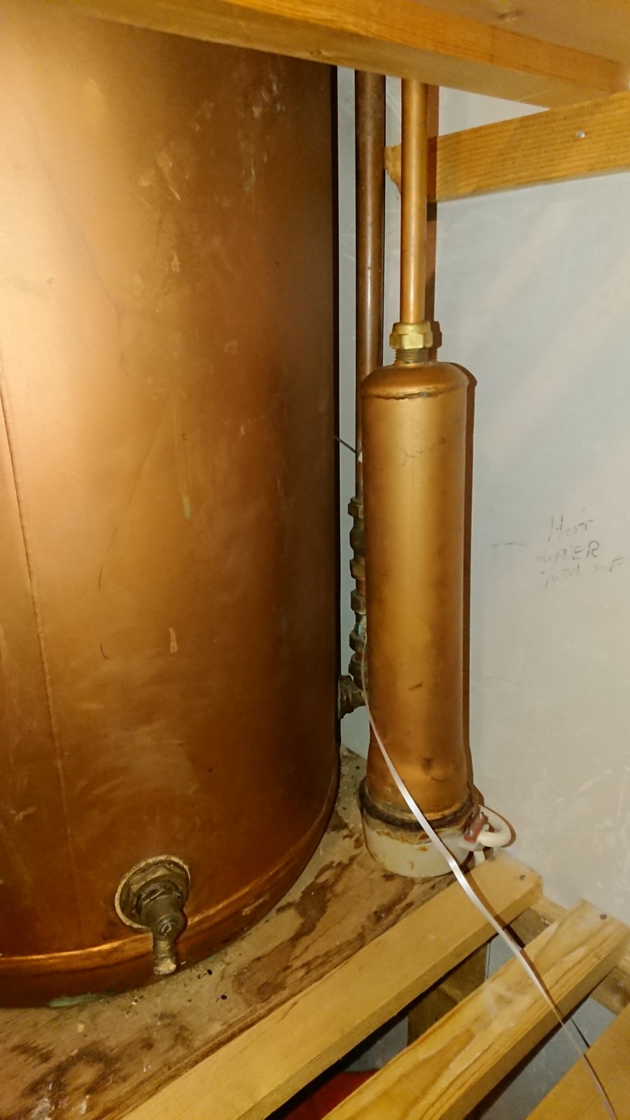

Looking at that cylinder, you have a fairly ancient setup, I agree with Stem, and would have to question if it's ever worked properly. Gravity Primaries, (flow and return pipes from boiler to cylinder), need to be a minimum of 28mm diameter for a gravity system, 15mm is just not going to transfer enough heat, which may be your issue....
Basic premise is, boiler heats the water, which flows up to the cylinder by gravity. Some control was used in a few cases with a 'C' plan system, by use of a cylinder stat and motorised valve on the Primary return pipe, but this was quite basic in the grand scheme of things. If CH was required, the pump was simply switched on to move heated water from the boiler around the radiators.
What is the small copper cylindrical item in the last pic connected to?
