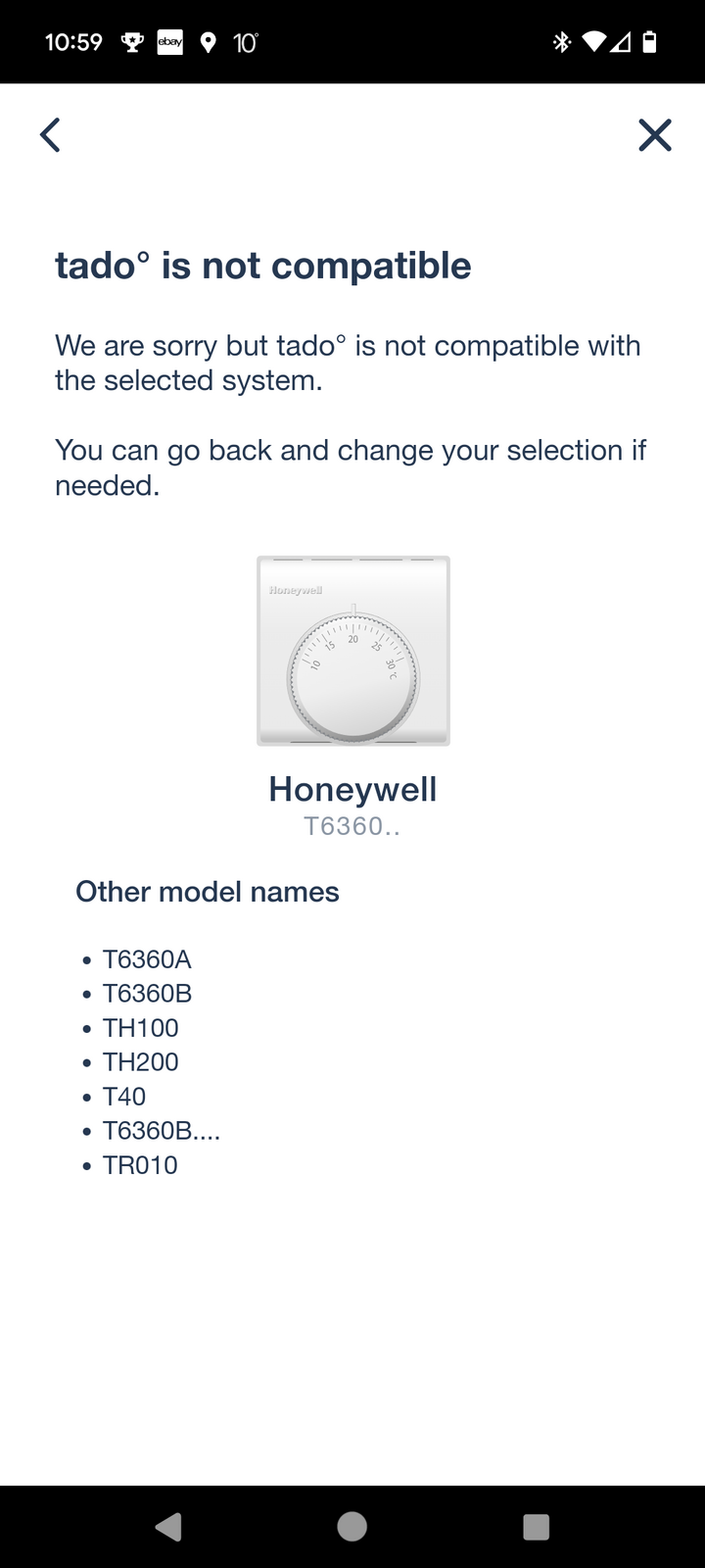

Got the wireless version, then found it doesn't work with the old system. So I swapped it for the wired version.
Now it says my Honeywell thermostat - mechanical T6360B is not supported!
What next?
Thanks.
What next?
Thanks.
Can you explain in a bit more detail?
Sorry I forgot to include the screenshot.
Yes, that's what I am trying yet it says it can't replace my old thermostat.

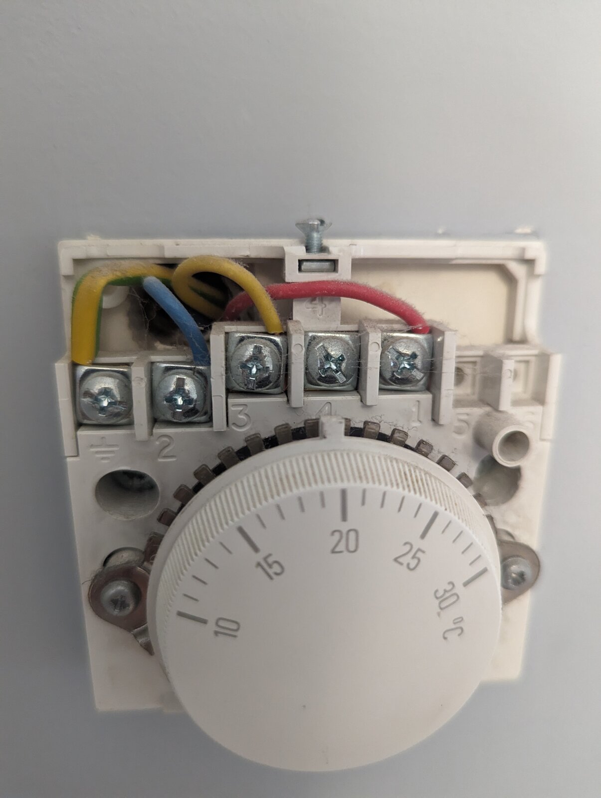

So compatibility doesn’t come into it. Remove the Honeywell and connect the wires together that are in terminals 1 and 3. Safely isolate the other wires. Make sure you have switched off the power before touching anything.
With your existing wiring, any Tado could be fitted in place of your existing stat.
Although it may be worth checking that the blue wire is indeed connected to a neutral at the other end of the cable.

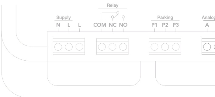

I.e. for the wireless receiver...
Blue would connect to N
Red to L
Yellow to NO
Additionally, a short link wire would be added between the second L and COM.
The green/yellow earth wire would go into a parking terminal.

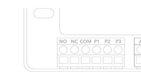

For the wired stat...
Red to COM
Yellow to NO
Blue to parking P1
Green/yellow to parking P2
Your current stat could be listed as incompatible, purely because there isn't an illustrated example of that exact model, on the app yet - your wiring should be compatible!

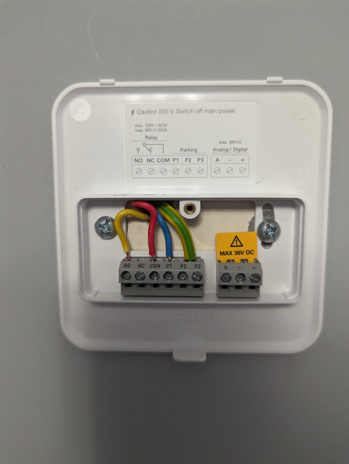

Thank you, @RandomGrinch - that's very helpful.
I have wired them up as per to above and powered on the power.
The boiler has started heating. I turned down the temperature to below the current air temperature, but the boiler is still running.
Any ideas? I am wondering if the yellow should go to NC?
Thanks again.
How long have you left it running for?
Some boilers have a pump overrun to dump some of the heat from the system.
No, NO is the correct terminal.
Your old thermostat was basically a simple switch, connecting together the red and yellow wires.
If the old stat was working correctly, so should your new one.
Is the boiler still running with the Tado removed from the back plate?
