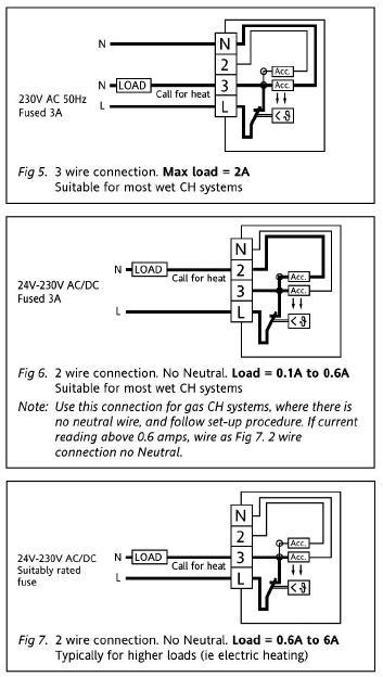

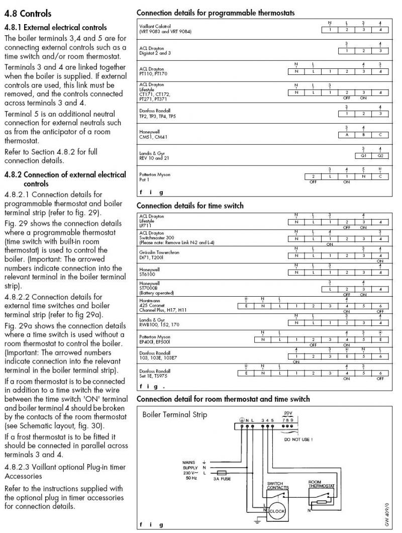

I have a Vaillant Turbomax boiler, Drayton RTS8 Thermostat and a Siemens RWB7 Timeswitch, which I'd like to connect together.
I have attached images of the wiring diagrams from the respective manuals.
Please could someone give me some guidance on how to connect these three devices together, and what cabling I should use between them.
