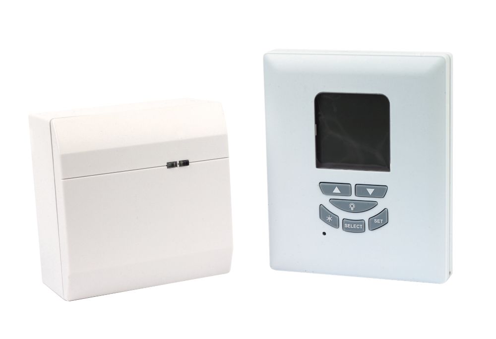

Horstmann HRFS1 Programmable Room Thermostat is under £60 and to program to lift the temperature in stages works well. So if you expect to be home 6pm then 5:30pm raise the temperature to 18°C then at 8pm to 20°C this means when you get home chill is already gone so ramping up to 20°C does not take long.

The Horstmann HRFS1 Programmable Room Thermostat I show has fixed frost at 5°C it is in fact a pain as too easy for some one to press the frost button in error when picking up the unit to look at it. Which means central heating is turned off.
