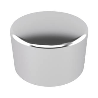

Now that I have a Hive Thermostat in my living room I no longer need a Thermostatic Radiator Valve attached to my living room radiator.
It’s simple enough to remove the TRV but I wondered if there was a cap that could be put in its place much like there is a cap on the valve on the other side of the radiator.
After a quick google I found this:
http://www.screwfix.com/p/white-universal-radiator-valve-cap-25mm/35656
Before I spend the time getting it I just wanted confirmation that this is indeed what I am looking for.
That linked screwfix product is not suitable.

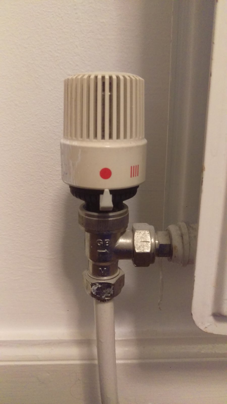

If your removed trv sensor was attached with a thread then measure the diameter across the threaded valve body. There is a good chance its 30mm and caps are available from screwedfix.
if it was not attached by a thread,:idea: tell us the name on the trv and post a photo of both parts so the correct part can be sourced,if available.

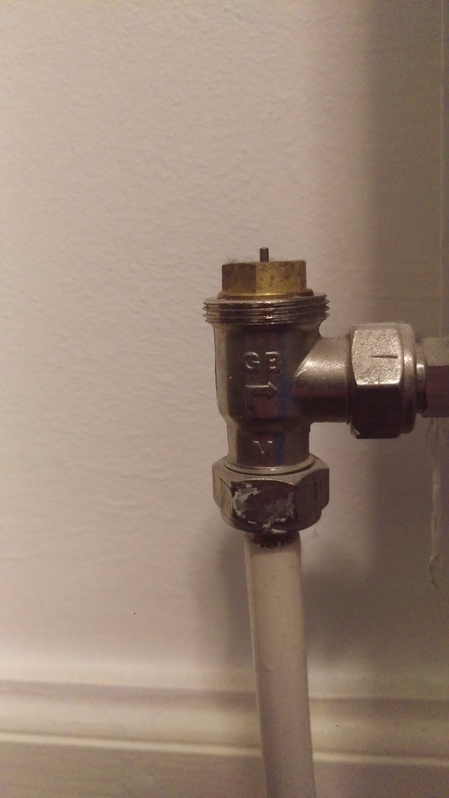

The Myson TRV was attached with a thread and the thread diameter appears to be 3cm (9cm circumference)

30mm (m30) http://www.screwfix.com/p/drayton-radiator-valve-cap-0735125-2-pack/8836r
View attachment 126141 They are available in white from some stockists if the chrome is to blinghy.
