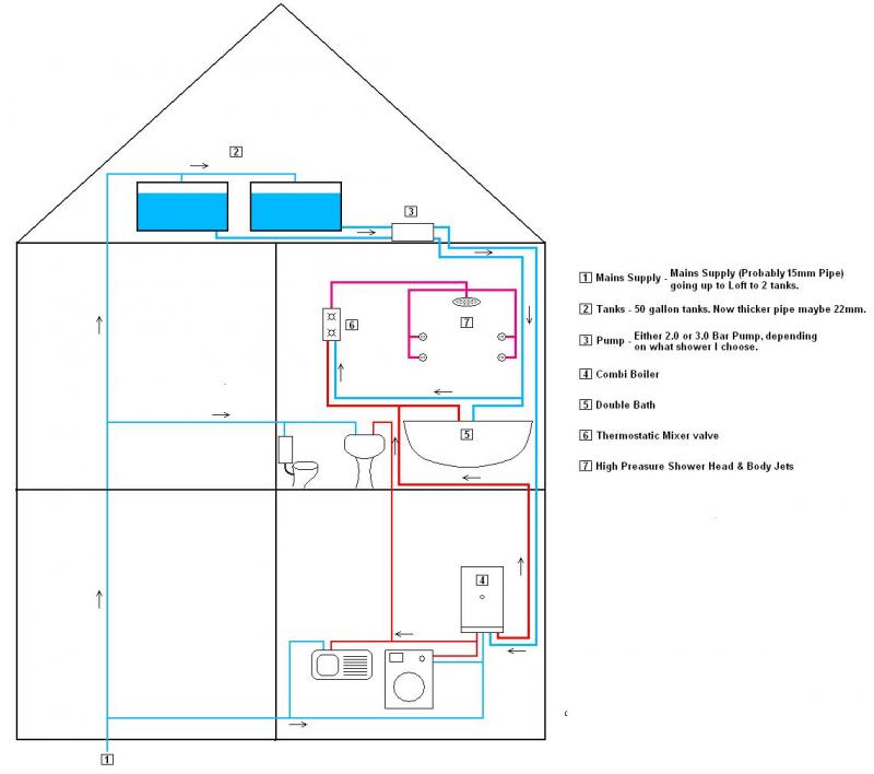

I want to upgrade my shower to a Thermostatic Valve, high preasure 14in shower head and body jets.
I've had a manual mixer in the past and it had very poor performance, especially in the morning and in the winter. Low preasure and extreemly low flow rate. So i currently have a 9.5kw electric shower which i'm also not very impressed with as in the morning it has very poor flow, and also doesn't seem to be able to cope with the current low temperatures.
To combat this i was thinking of installing 2 100 Gallon tanks in my loft, they would both feed into a pump, one to the combi boiler to become the hot feed, and the second the cold feed.
Is this allowed, as i know you cannot pump mains, but i wouldn't be pumping it at the mains as it would be pumped after the tanks.
So first question is can I pump from a tank into the boiler?
Are there boilers on the market that have multiple in and out feeds? My current boiler only has Central Heating in and out and Water feed in and out.
If I can get a boiler with multiple inlets then my whole system will not have to be pumped.

Yes you can pump to a combi but it should be a fully automatic pump not just a shower pump model.
Also the pressure and flow rate should be in line with the boiler mi.
I would recommend a pressure regulating valve too.

Hi XamSpeP,
I don't believe you will be able to achieve what you want from your current set-up. My concern is around how you are obtaining the hot water - in this case via a combi boiler. The problem is you will only be able to extact somewhere in the region of 12-15 l/min of hot from the boiler.
Your diagram shows 4x body jets and 1x large overhead shower. From experience each body jet will require 4-6L/min (minimum) and the overhead is going to need at least 12-14 L/min - thus with the whole lot turned on your going to need something in the region of 38 l/min of water - your combi bolier will not be able to satisfy the needs of your shower set-up and the whole thing will just run cold or extremely low flow.
The only way that you can achieve what you want is to employ a different means of supplying the hot water - either through pumping a gravity fed system or using a higher-flowing mains pressure system (e.g. megaflo).
Hope this helps you

I've had a bit of a re-think, how about a system that requires 18l/m. Above it says that I'd get around 12-15l/m from a combi, so together with the cold water, would I have enough flow to supply this new design.
