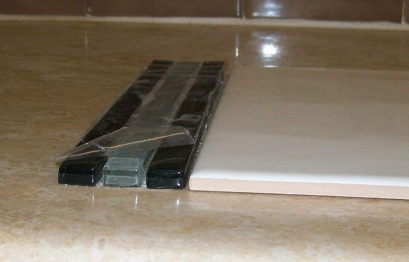

I'm helping a friend with his bathroom, and my first question is regarding the borders he's chosen.

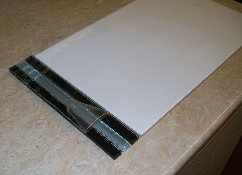

As you can see, the glass border is a bit thicker than the tiles - would it be OK to press them a bit deeper in the cement to get them flush ?
It’s usually the other way around which is easier to accomodate; what you could do us use a solid thick bed (floor) trowel on the - 20mm round notches, 10mm deep, at 28mm centres; the larger trowel will give you a slightly thicker adhesive bed under the tiles allowing you to set the glass tile border further back but, to be honest, I don’t think you will really notice it. I have glass border tiles in my own bathroom & these are slightly proud of the tiles either side, I don’t notice it & no one has ever commented on it.

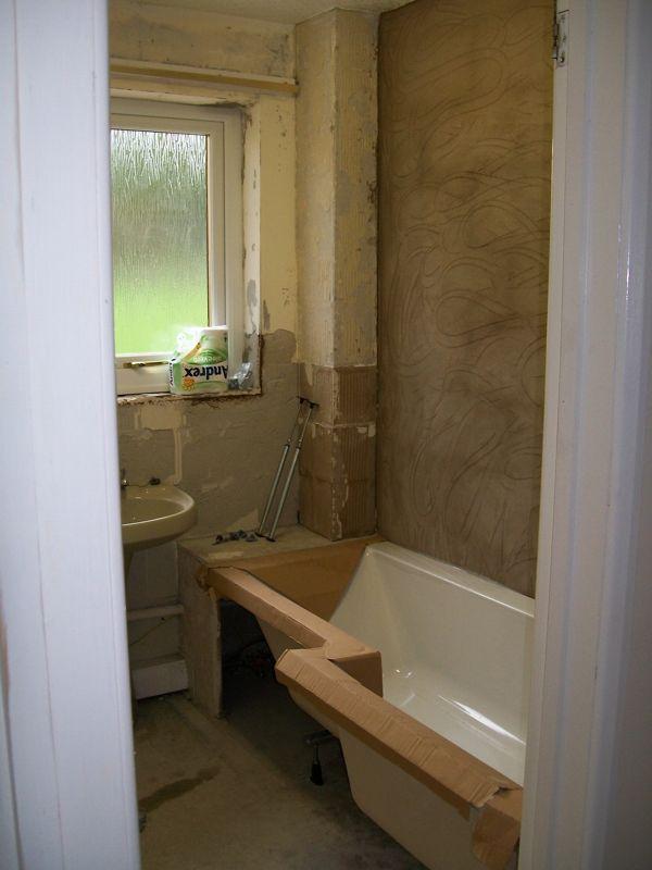

Lastly, the wall behind the bath (bath-ceiling, length of bath) was left bare as nearly all the old plaster came off with the old tiles. It's been rendered I think - the plasterer was told we'd been tiling over it, but to me it looks like sand/cement render with some wiggly grooves scratched into it. Do we need to do anything before tiling over it ?
No not really but you might damp the render down a bit with an old kitchen spray to kill the suction a little.

Re-reading your post, I’ve had a thought about your wall behind the bath. Check to make sure it is indeed a sand/cement render, base plaster is not a suitable tile base. Unless a quick set render has been used, you must also leave it to dry out before tiling; a 12-15mm render base will take up to 28 days to dry & reach max strength, if you tile over it before hand you could end up with problems.
Thanks for that, much information. The wall was done a couple of months ago, so it'll be dried out by now.

How would I tell what the guy used (apart from phoning and asking) ? It feels just like sand/cement render, perhaps you can tell (guess) from it's colour ?

The wall behind the bath looks like conventional sand/cement render to me. The adjacent wall looks like plaster or at least the majority of it; if in doubt acrylic prime it.
Yes, the far wall is plaster, needed quite a bit of making good as some of it (mostly just the top layer) came off with the old tiles. What was left seems solid enough.

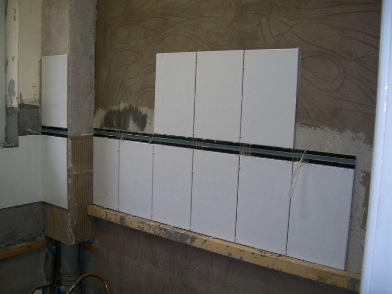

Started on tiling the walls, got the first two rows of full tiles on the far end. Now they're fixed, next step is to fix a batten on the rendered wall so we can start that, and fill in with the cut tiles on the back wall. At least these large (250x400) tiles fill an area nice and quickly :)
As for the top of the border, we've decided to put a 1/2 tile above it which brings the top of the tiles to a convenient height. So the border will be bounded top and bottom with tile.

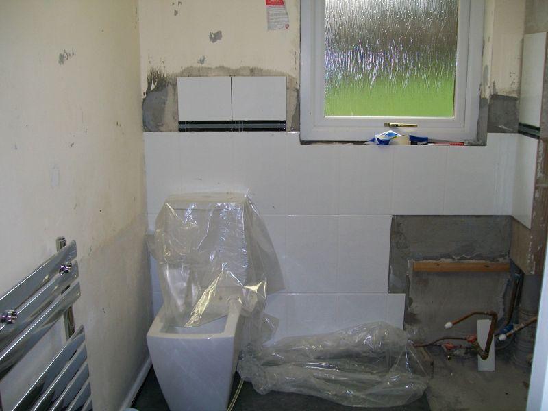

Back wall is almost tiled - our priority was to get to the point where the toilet can be fitted, for what should be obvious reasons. Didn't get the wall as flat as I thought, but with the toilet and sink there it won't really show. The side wall didn't seem too bad when I had another look, but I gave it a light skim with tile cement to fill in the hollow bit.
The borders did press in quite well, so they are almost flush with the tiles. The little "loose" squares at one end kept trying to sneak out a bit, but I think we got them all sorted. Should look OK once the plastic is off and they're grouted.
Anyway, getting the hang of it now so the rest should happen quite quickly - and I can leave my mate to do the grouting on his own as "homework".
