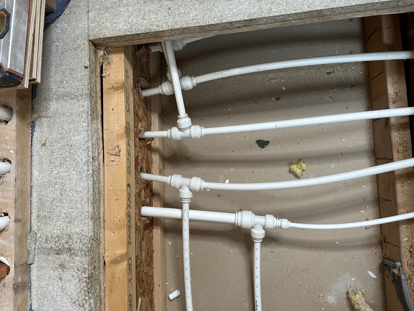

I’d prefer to replace the P5 but the way the joists are positioned makes it a little tricky to get the floor secure. If I cut the size of the tray I’m not sure how to secure the plywood I replace it with as there’s no joists near the dividing wall. Hopefully this makes sense.
Ah ok - you have I joists - a little more tricky. If it was normal joists you could just drop the CLS support down level and screw from the back side but with I joists they don't have as much lateral support so not sure you could really do that. That and you'd also lose the support to the P5 on the other side of the wall. Only way would be ot cut the flooring on the side and drop in lateral supports.
OK, it's an ideal to add in extra support underneath but if it's a stone resin type then the board on top should be enough.
I’ll add in some support across the joists and some plywood on top.
