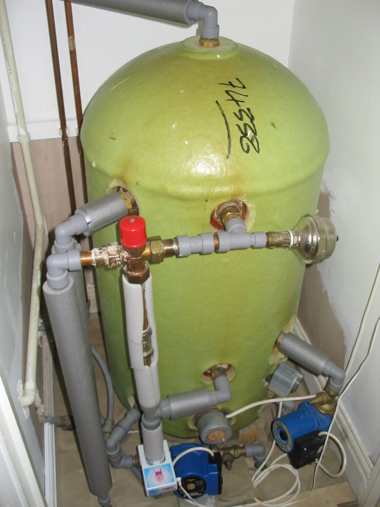

The system is a thermal store btw. Open system with F/E tank above the main tank in the airing cupboard. 2 pumps, one to the conventional boiler to the tank and one to the radiator circuit to the tank.

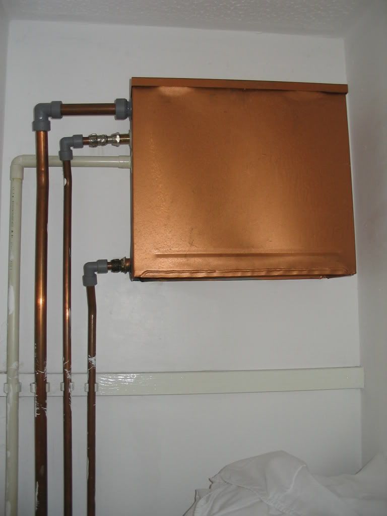

Here are pics of the main tank and header tank.

Also is it worth me trying to turn my central heating circulation pump around and pump the other way? Is it possible? Will it cause me more problems?
The pump is the one on the bottom right hand side of the picture. Its a 3 speed circulation pump.
