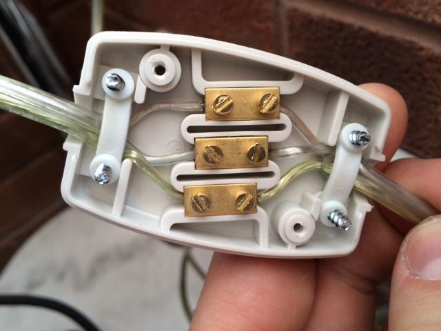

So the dimmer pack in a quite expensive floor lamp stopped working a while ago (well the whole lamp stopped working). I was told by the manufacturer that the fuse in the pack was probably knackered and couldn't be replaced.
So I cut away the dimmer pack:
... and bought this connector thing from B&Q:
... and it connected it all up:
The lamp works again now (without a switch of any sort - which isn't a problem as it's controlled remotely) but does this all look ok? I'm not going to burn the conservatory down am I?!

It may be safe, but I don't have X-Ray eyes and can't see how you have wired up the connector. A picture with the lid off would have been more useful :rolleyes:
Hi TTC,
There was a lot of faffing about with different fuses - some made the lamp work (without the dimmer function) but that worried me more about something going wrong!
Here's a pic of the inside - I think the wiring should be fine - it was more the principle of what I've done (knowing bugger all about electrics!)
Thanks!
You want more of the outer sheath under the clamp. It needs to be sticking out at least 3-4mm.

The triad is short circuit then. That is the component on the heatsink. Easilly replaceable by an electronics engineer.

It's a TRIAC, and it doesn't take an engineer to fix..

OOI - How would 'faffing about with different fuses' some of which made the lamp work, transpose to the diagnosis that the triac being faulty?
If you still want the dimming function, replacement dimmers are readily available:
http://www.mr-resistor.co.uk/controls.aspx?t=603
and is a far safer option than attempting to repair the existing unit.
Obviously some people could safely repair it - however plenty could not. Dismantling and repairing mains voltage electronics is not something most people should have a go at doing.
Because, as you said, QUOTE: (without the dimmer function)
When the lamp failed it took out the fuse and the triac. Simple job to repair.
