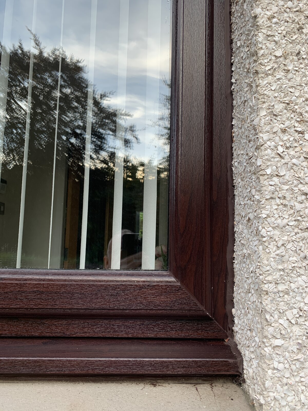

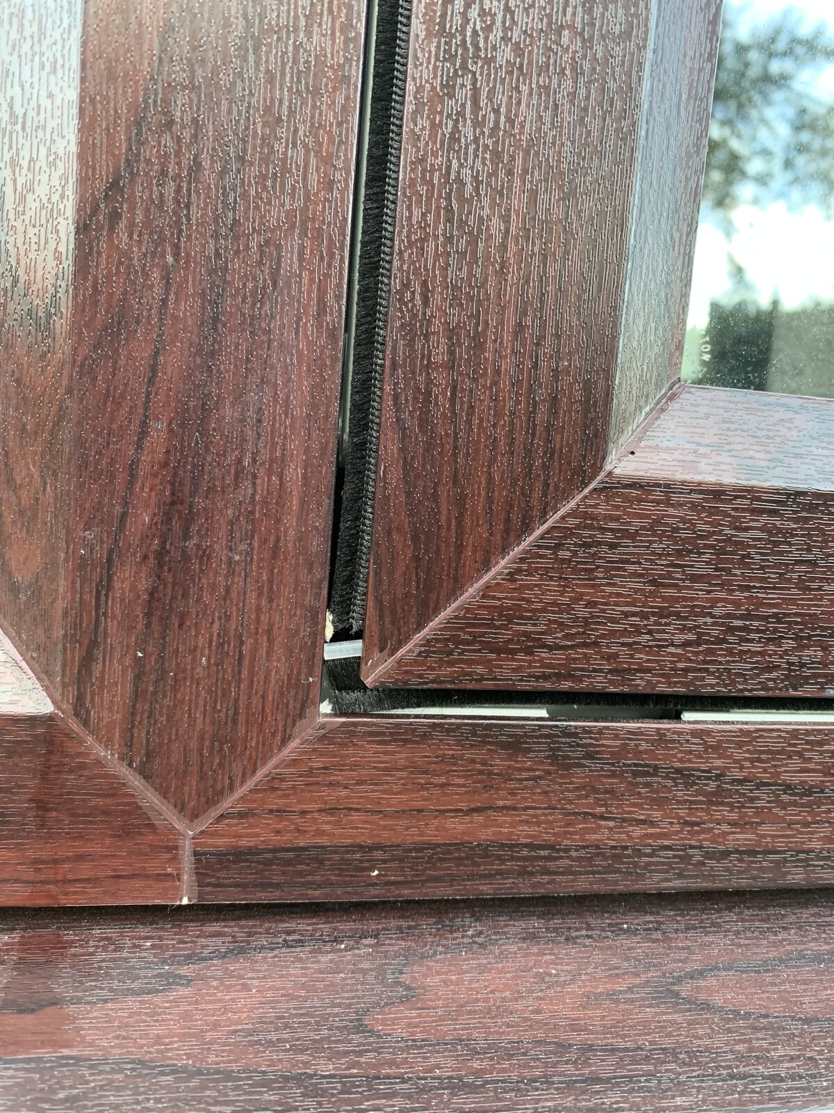

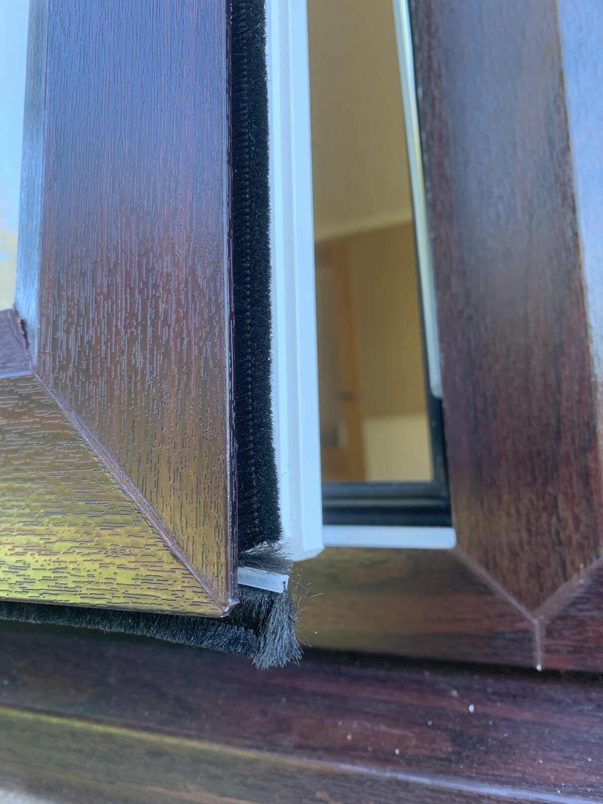

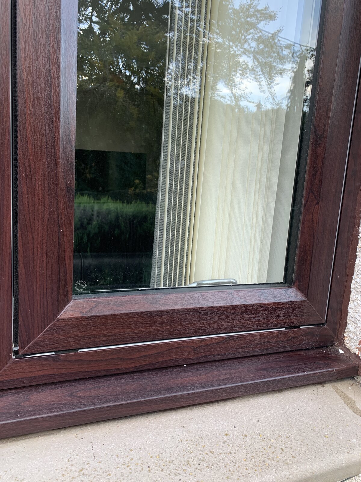

Hi all, we recently purchased a property ( Scotland) which had 1 door and 10 windows fitted in March 2023 for around £12k
The door and 9 windows all appear fine & all are the type that overlap the frame by around 5mm pic 1, however the 2 casement windows in the main lounge frame appear to be the wrong size for the frame and appear patched up as there is a 5mm underlap! on all sides, per the pictures.
Also none of the windows have trickle vents which I thought were a requirement since 2022.
Any thoughts, advice etc would be greatly appreciated.
they must be flush fitting windows not stormproof -you have 2 different styles of windows probably fitted at different times
if the brush seal weather strip is held in a groove in the sash stiles and rails then the windows are not patched up but intended like that
trickle vents: they werent necessary on replacement windows (depending on what they were replacing) but they are necessary nowadays...but the customers might have said they didnt want them....they do let noise in

That was my thinking, but I was unsure why these had not been fitted at the original installation as, from what I understand, this is a requirement rather than an option since 2022 and why 1 window would be fitted which have open gaps big enough to see the inside all around, ( not covered up by the brush fittings, rather than similar style to the other 9.

The two rogue windows definetly look like Flush Sash casements but there does seem to be some gaps.
