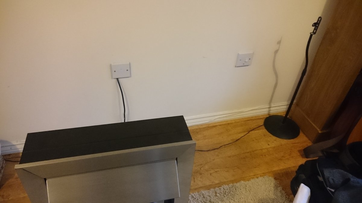

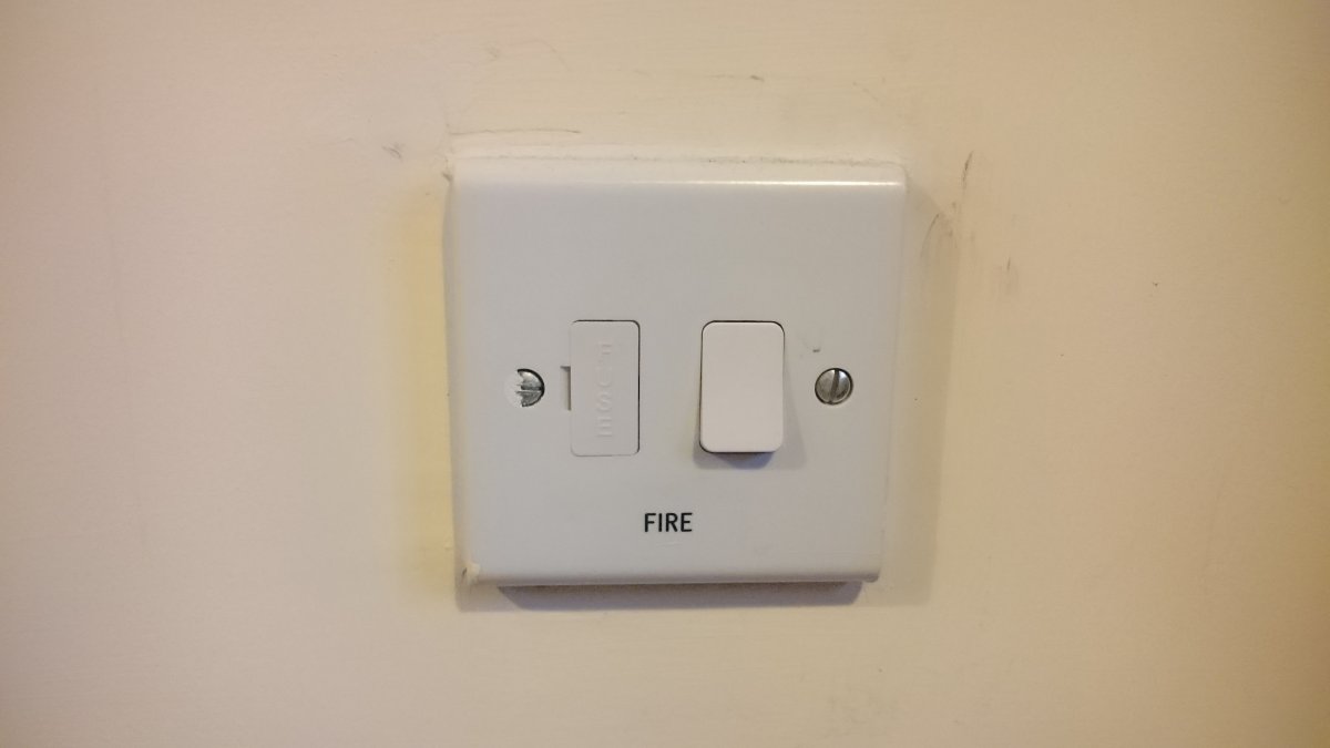

I'd like to remove my fireplace. It seems fairly straight forward. But there's 2 fuse points.

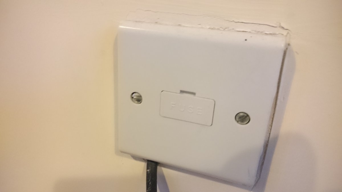

So it goes fireplace hardwired into fuse box one (13A). This is on the left, has black fireplace cable in, grey cable out to right. As you'd expect. (at least I would).

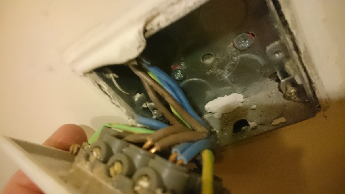

But then there's a second fuse box on the right with a switch (13A). This has 3 sets, what appears to be 2 in, 1 out (to the other box).
My plan is, remove the fireplace, remove the left box and plaster over. Take out the cable between the two boxes. I'd like to remove that right hand box too, but it's not essential.
I'm assuming that the left box is an extension of the right box which is A: a spur from somewhere, B: on it's own cable. But I'm wondering really, why is there 2 sets of cables coming into that right hand box?
For your info, there is a double socket and aerial point 7ft to the left at the other end of the room. There are no sockets to the right. But a double on the opposite side of the wall in the corner (if you turn around). If I cut the power at the consumer unit to "sockets", it disconnects power to the fireplace switched fuse box.
Ultimately, I want to put in some LED downlights on this wall and take the power from the far left double sockets (it's next to a soil stack I can run them through). Do you think the chances are the fireplace spur comes from the left sockets to the right fuse box then doubles back on itself to the left fusebox?

The right hand switched fused connection unit appears to be located directly on the ring [rather then a spur] hence the two cables in and provides fusing down and functional switching of the fire. The unswitched fused connection unit behind the fire is just used as a flex outlet and did not need to be fused.
Your best bet would be to replace the switched fused connection unit on the right with a single socket outlet. You could either disconnect the cable going to the point on the left, cutting it off short at both ends, and then plaster over that point.... or leave it connected and change that to a single socket as well
Ah ok, so, forgive the dumb question, but a ring circuit is basically a loop from and back to the consumer unit right, with sockets or switches wired in serial right? So surely I'd be correct in saying that if one socket broke, everything on the ring would fail?

So I guess I could remove and plaster the left box. Then I could, if I wanted, join (choc block and tape) the 2 sets of wires inside the right switched box and remove the box and plaster over that - that would be absolutely fine right.
No, it would not be fine, because tape is not needed, and if anything is needed around a choc-block, tape won't do.
No, it would not be fine because you aren't allowed to have screwed joints inaccessible.
No, it would not be fine because you aren't allowed to have cables buried in a wall like that without there being accessories to alert people to their presence.
