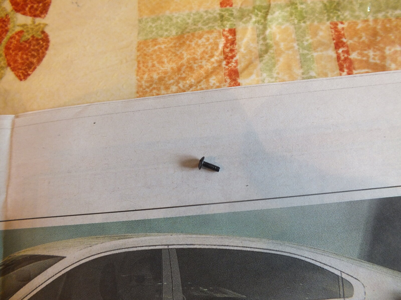

A machine screw has just dropped out of my best Shimano fishing reel and I am hoping I can determine the thread size and buy a few replacements.
My best measurements are
1.92mm MAX across the threads of the bolt.
A 6mm/1/4 inch screw has 14 threads = 56 TPI
Could it be M2
If not what?
Uploaded photo which you may be able to blow up.

Very difficult, that one Mike but the common USA thread is UNC @ 64 tpi, and gives a micrometer measurement of .0755".
I think I'd be getting in touch with the manufacturer about this one!
Good luck with it
