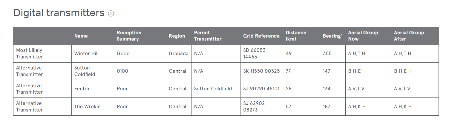

TV aerial signals can be split and distributed around the house relatively easily. All TVs have an aerial socket, so they're 100% compatible with this. If you want a small telly in a bedroom or another somewhere else, then this is the way to go. The only real caveats are the initial cost and making sure first that there's decent signal for Freeview reception. The aerial guy should be able to tell you, but if you want to check yourself then put in the house postcode and number into this checker: https://www.freeview.co.uk/corporate/detailed-transmitter-information
Once the page updates then scroll down. The first bit of relevant info is a list of your likely transmitters and what the basic reception is likely to be. For my bit of Cheshire, then the results are as follows.
My most likely transmitter is Winter Hill. Your mileage will vary.
Below that you'll find more detailed info for the listed transmitters. The following is just the top two.
From here I can see that Winter Hill gives me strong signal right across the board. If I were to redirect the aerial from Winter Hill (Granada) towards the Sutton Coldfield transmitter (Midlands) then the reception wouldn't be as good.
The predictor can't take account of local issues such as trees blocking the reception path. You'll have to take it with a pinch of salt. However, if you look at the neighbouring houses and find that they've got aerials then it's a fair shout you can have the same.
