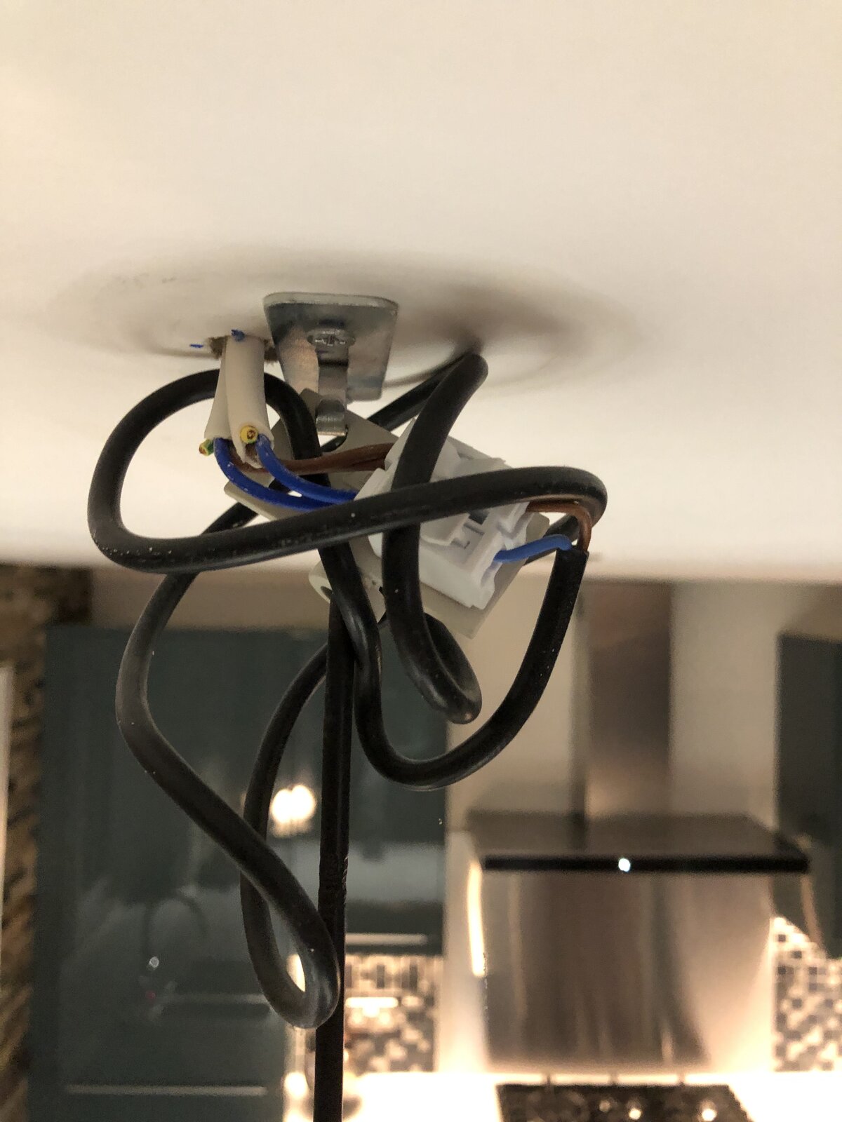

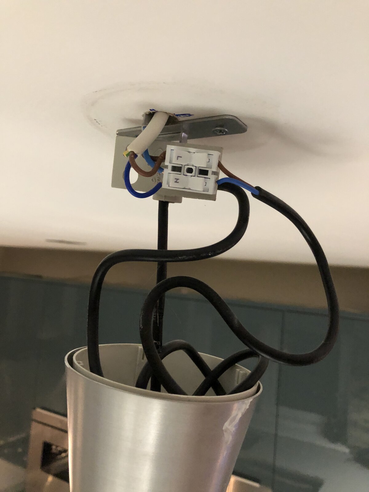

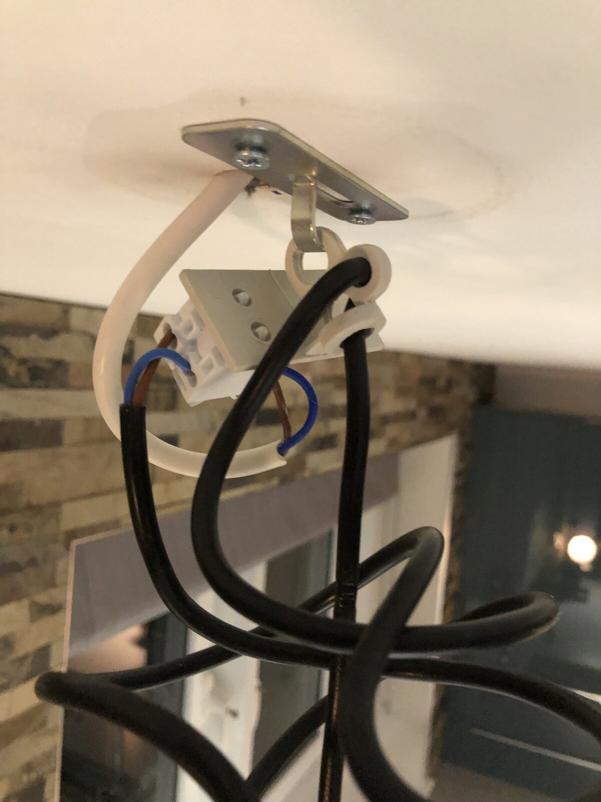

I'm assuming this is pretty straightforward, but would like a bit of reassurance on this thanks -
Above our breakfast bar we have three pendants all under control of a single switch.
We are changing this to a new light which is a single pendant in the position of the central existing pendant.
So - question is - what do I do with the wiring to the existing pendants on the LHS and RHS?
Photos of existing wiring below.
Looks as if the supply comes into the fitting in the first pic (in twin & earth) then links to the other 2 using flex.
2 choices;
1 Terminate the LH and RH wiring using maintenance-free connectors in suitable enclosures, stuff them into the ceiling and make good
2 See if there's enough slack on the T & E to get to the centre fitting. See if the flex from centre pic to LH pic moves at the LH end when you tug the centre end, repeat with flex from centre to RH pic. If flexes move freely and there's enough slack on the T & E then junk the terminal block in the LH pic, twist the end of the T & E onto the end of the flex, tape over, carefully pull the flex from centre til the T & E appears. Disconnect flex going to RHS, remove it. Terminate and hang new fitting, patch holes.

Did the new fittings instructions mention anything regarding Earthing, as your pictures show the existing Earth to be cut off at the old 1st point
