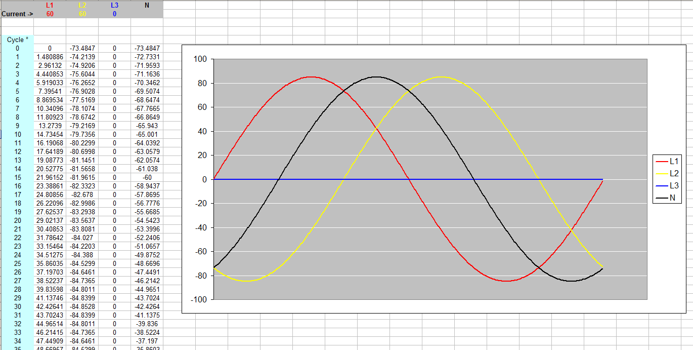

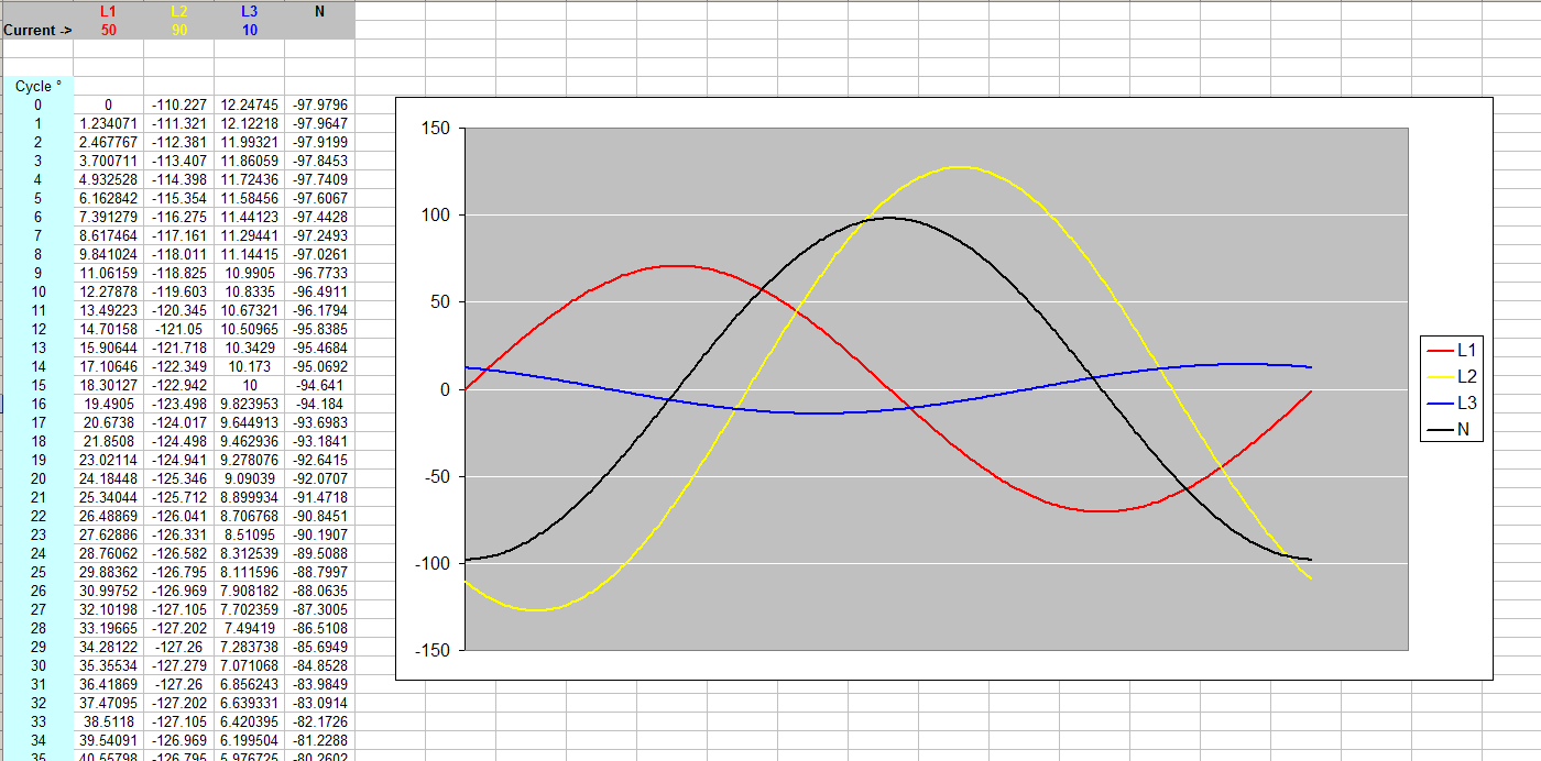

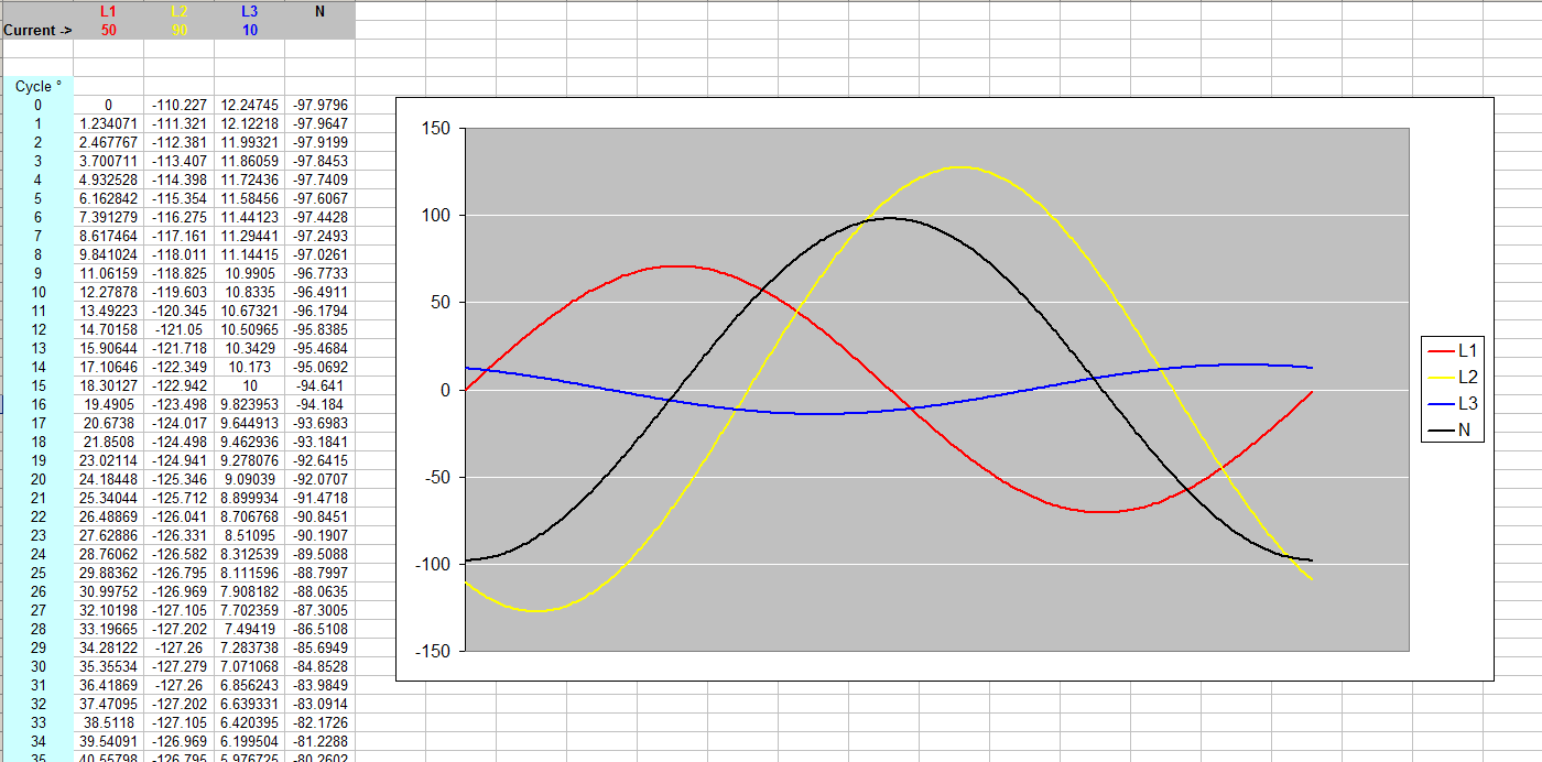

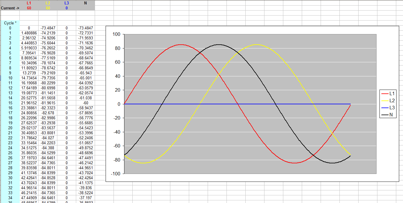

The other thing you could do, to visualise it, is to play around in Excel (other spreadsheet programs are reportedly available) with different currents for each phase, just add N=L1+L2+L3 at each point in the cycle, and plot a chart.
e.g. your example #1:
#4:
Note, as I was plotting the curves for each phase I figured I'd use the peak values, but it's all relative, so doesn't really matter for visualising the magnitude of N wrt L1/L2/L3.
#4:
Got it wrong BAS your phases are 60° apart, they shoud be 120°
